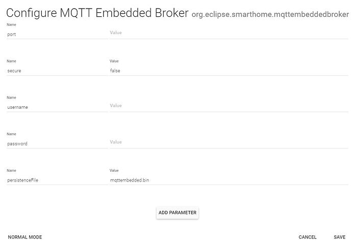

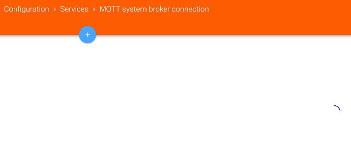

I looked around at PaperUI but could NOT find those values anywhere. I defined my THINGS vs. using PaperUI and found the 2 entries and changed them to “false” there.
Bridge mqtt:broker:roomba "Roomba Main Floor" @ "Main Floor" [ clientID="xxxxxx", host="192.168.0.143", port=8883, secure=true, username="xxxxxx", password=":xxxxx", certificatepin=false, publickeypin=false ]
  Thing topic state "Roomba Cleaner State" @ "Main Floor" {
    Channels:
      Type string : wifistat "WiFi"    [ stateTopic="wifistat" ]
      Type string : shadow   "Status"  [ stateTopic="$aws/things/3164420C50229600/shadow/#" ]
Here’s what my PaperUI looks like when you don’t use it for configuration.
Best, Jay
