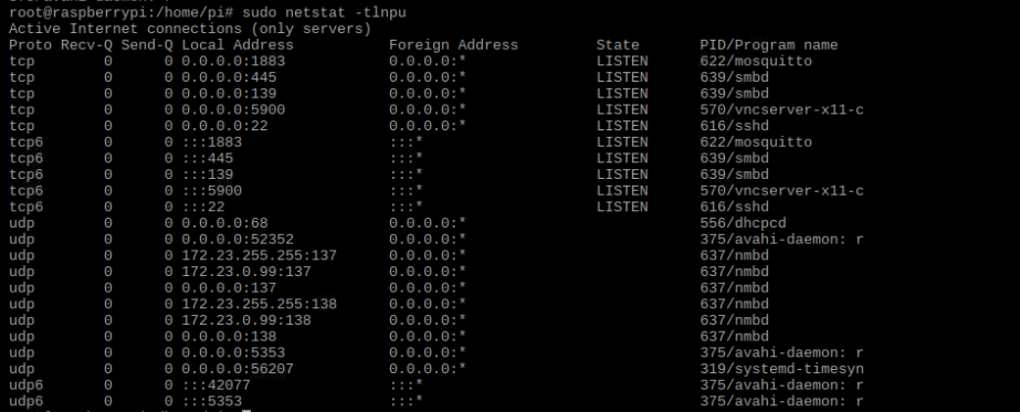

I ran netstat to check the service running on that port , see this image
check it:
add “listener 1883” to /etc/mosquitto/mosquitto.conf
