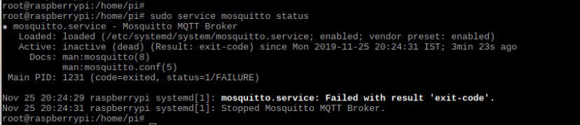

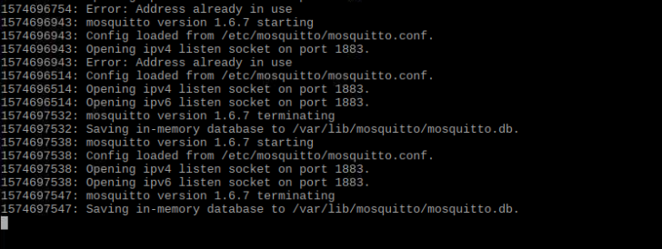

Hii hmerk,
What is the problem in my case ?
can you please help me ?
How shall I know ??
Check your mosquitto log if there is any
see this
You already have a service using port 1883
Change it
Or change the mosquitto port(not recommended)
