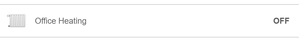

Switch OF_Heating_Actuator "Office Heating [%s]" { mqtt=">[mosquitto:cmnd/sonoff-1/POWER:command:*:default], <[mosquitto:stat/sonoff-1/POWER:state:default]", autoupdate="false"}
This is what I use on my Sonoff Basic/TH16 devices. The state in OH exactly matches the state of the output of the device itself.

[%s] will show the status of ON or OFF in your Sitemap:
(I’ve got mine set up as a Text item, as opposed to a Switch, as I will not be manually changing this specific item from the UI of OH)

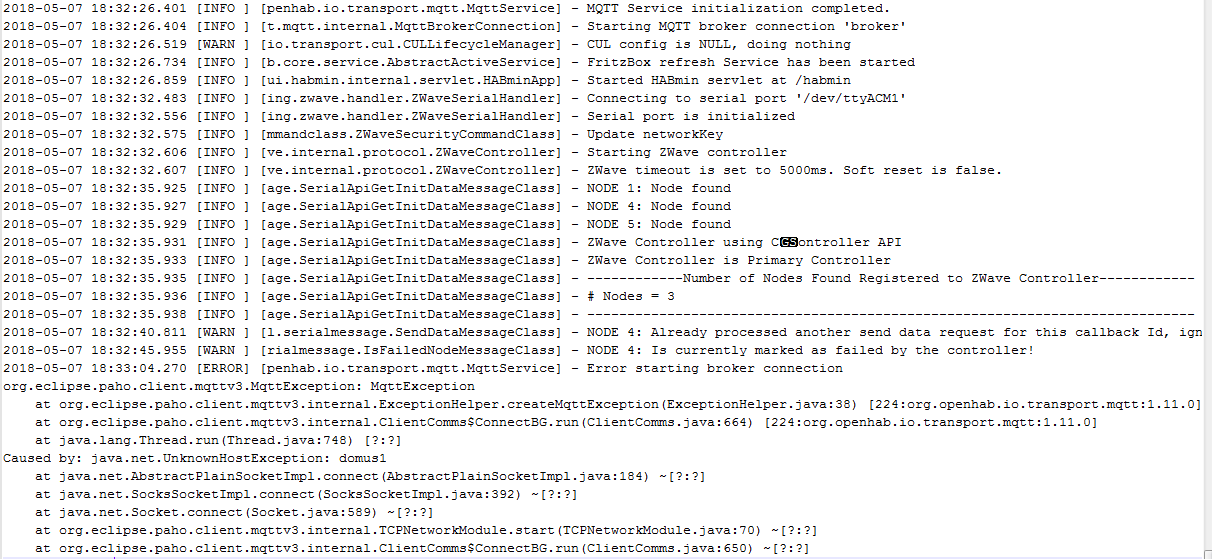

and this is shown in openhab.log, please ignore the messages for Cul and ZWAVE.
Something happens für MQTT but I don´t understand a word

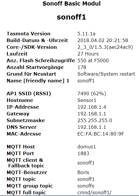

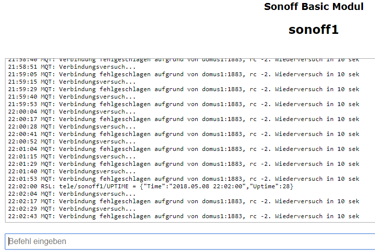

and this is shown in the sonoff console:
Your sonoff is not connecting to your MQTT broker. Check your MQTT settings
Do you have a computer on your network called “domus1”, and is it running an MQTT broker software, such as mosquitto?
Both OH and your Sonoff are attempting to connect, but can’t find a computer of this name running an MQTT broker, so are failing.

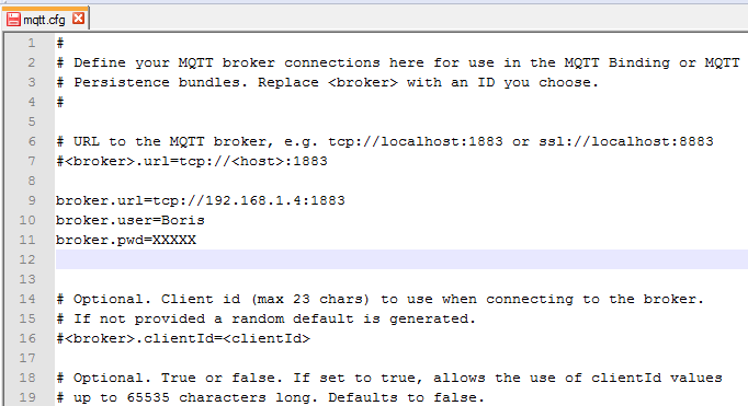

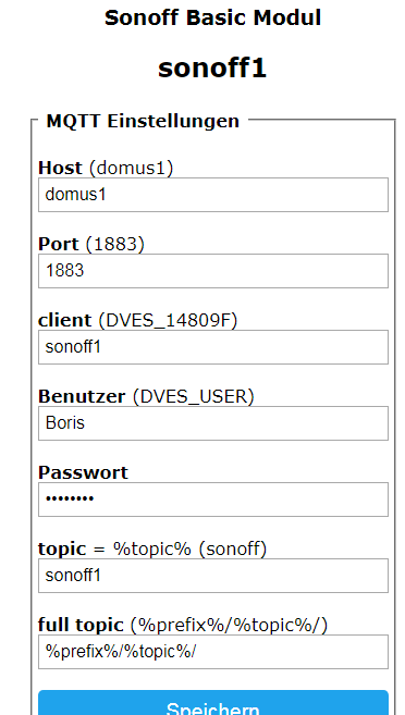

There is not much setting right?
The sonoff tasmota device is on 192.168.1.4
The IP in mqtt.cfg is the IP from the sonoff tasmota
The user and password are also these setup in the sonoff tasmota
No Typo but not working, what´s wrong here?
I already tried all combinations means user/pwd from Openhab and used
domus1 instead of the IP but no luck.
This is the MQTT settings in sonoff tasmota device (the broker)
and this is my mqtt.cfg
Have you install an MQTT broker and is it running?
And don´t know exactly what you mean but I am using a sonoff tasmota basic device and these settings I copied above are the once from that device, it is up and running I can access it via this IP address and I can see the console showing me wrong connections. Copy of this console output is also three messages above.
So Yes I assume the Broker (this sonoff tasmota device) is up and running
