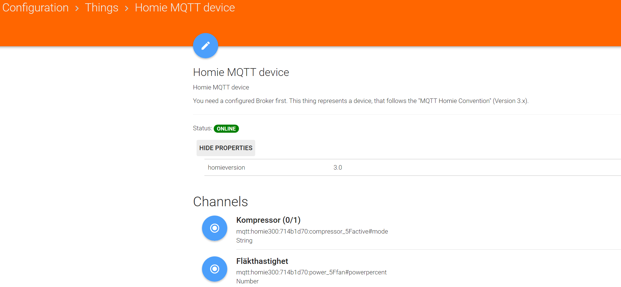

This may be a lead ?
From PaperUI. Note that this device is still Online, but the Channels looks weird?
That looks good. I think your pronlem might be related to the latest changes regarding encoding of special characters. Can you show the same view for the device that has problems?
Hi, no special characters should be in these channels.
“mqtt:homie:714b1d70:power_5Ffan#powerpercent” is defined as “mqtt:homie:714b1d70:power_fan#powerpercent”
Not 100% sure, but I Think that this “5F” is quite new. Maybe in the latest snapshot. Not sure.
At this Point, all devices works…
_ is a special character. There was a note during upgrade that old chanel definitions might fail.

They are. I think documentation needs to be adapted here. We have the situation that the homie binding maps MQTT topics to channel names. We had to find a way to make this possible for all special characters and the way is to escape all characters except A-Za-z0-9. This is done by converting the character to the equivalent hexadecimal string and prepend that with the allowed special character _.
So the topic command_topic is parsed, the _ is found, this is converted to _5F and the corresponding channel name is then command_5Ftopic. So the problem arises if you define a channel name with an underscore (sample_channel) and the homie binding (this is only happening for homie!) tries to convert that back to a topic. It sees the _ and expects the next to characters to be the hexadecimal ASCII code of the escaped character. Of course ch is not a valid hexadecimal value and the exception occurs.
