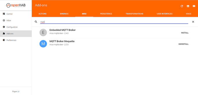

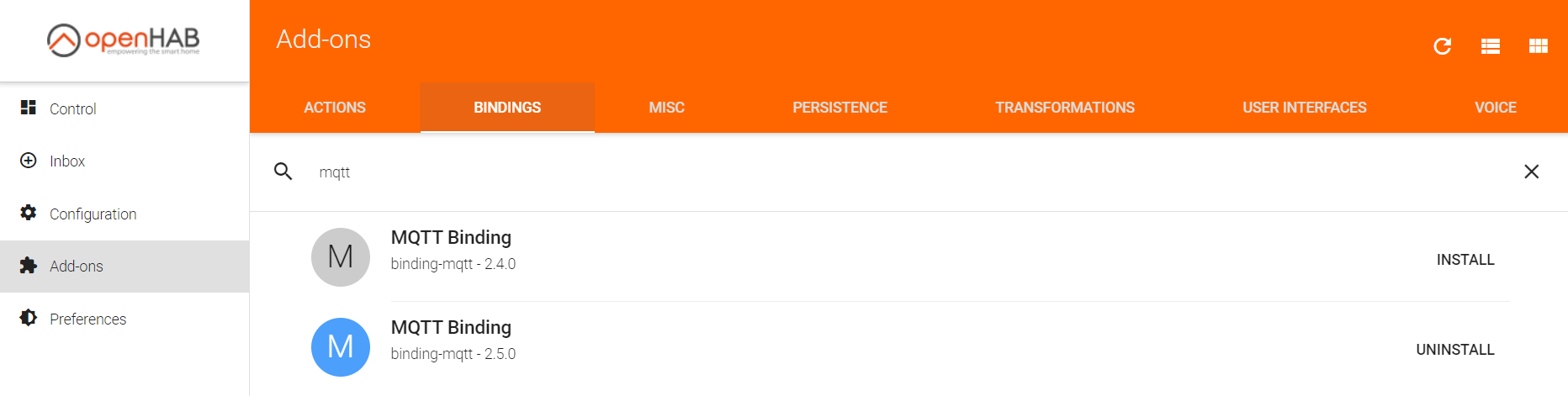

a) Install MQTT Binding from Addons

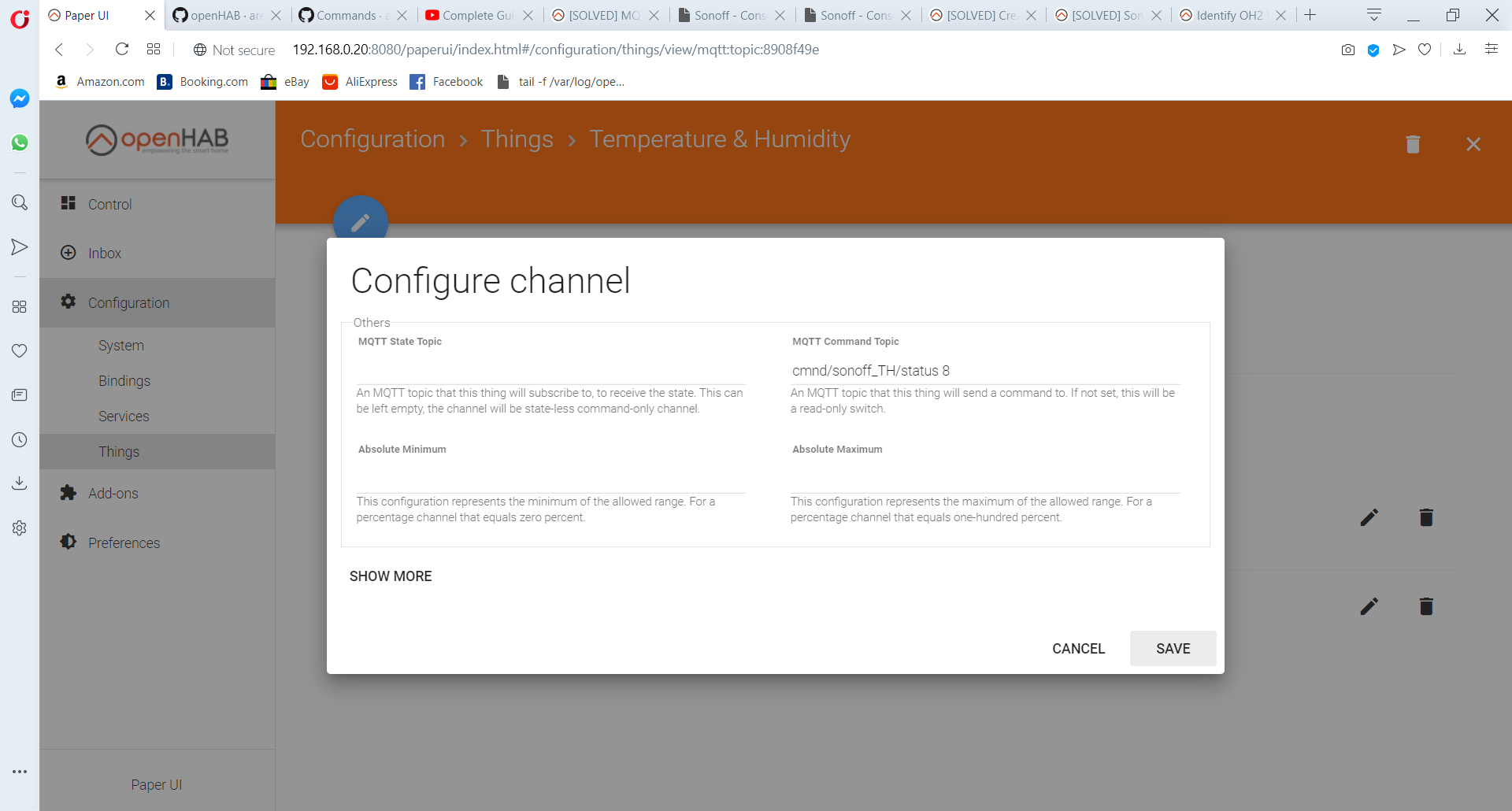

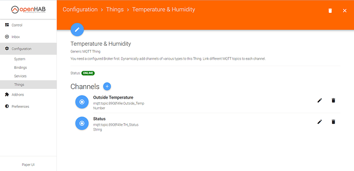

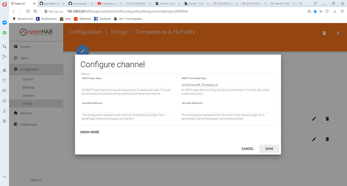

d) Add a new MQTT Generic Thing and let it use your currently added MQTT Broker
e) Add a rollershutter channel and use SHUTTERPOSITION1 in your command topic
f) Add new item with rollershutter Type and link it to this channel
as reslut you will get an Rollershutter like this:
You can see in the last screenshot, that i have added a Dimmer Channel ( Percentage value) that also can work with this settings.
