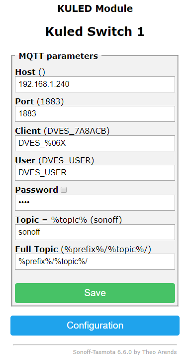

Here are my Tasmota settings for completeness sake.

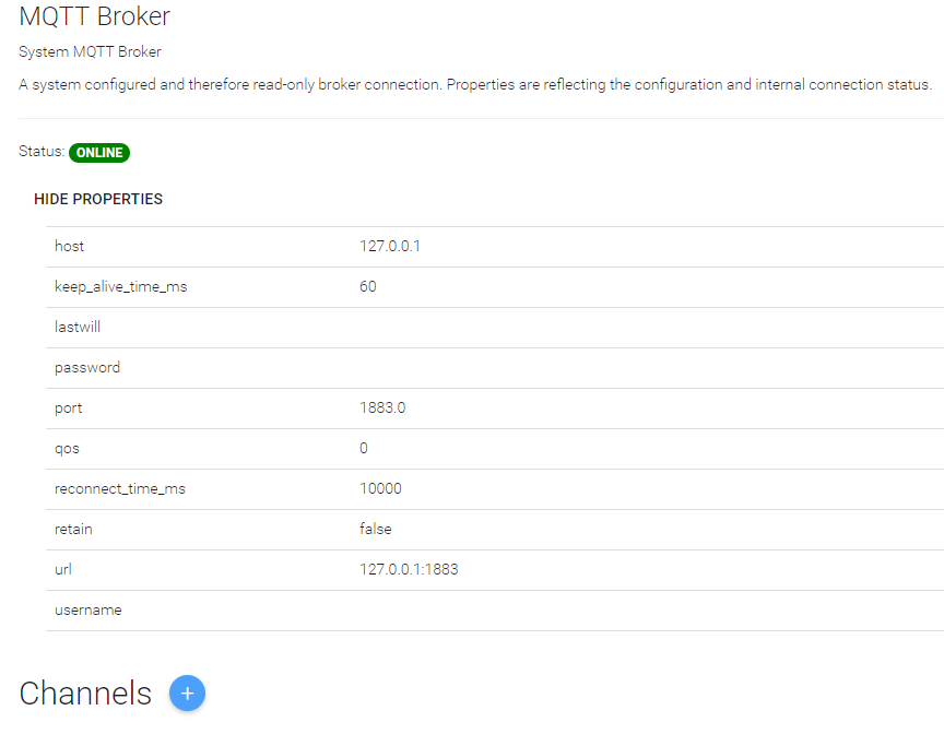

Maybe two areas that I’m not too certain about. I’m using the embedded broker, I don’t quite understand the difference between that one or the system one (or are they the same?) and a custom one I would create myself. I had trouble setting up a custom one and found using the embedded one was the easiest way to go. Is this not recommended for some reason? And I’m not using MQTT security, Tasmota shows a Client/User/Password but if I blank those out, they come back (with the exception of Client I believe), I guess that’s what the checkbox above Password is for; to disable security on the device side. I also have the secure=false in the things file, but I don’t know if that overwrites the value in the config seen below.. well if I had one set.
Again, thank you for all your help!
Nic
Have a look at https://learn.sparkfun.com/tutorials/introduction-to-mqtt/all or one of the many introductions to MQTT out on the web. There are tons of YouTube videos if that is more your thing.
To be successful in OH you need to have at least a basic understanding about how the technologies you want to use OH with work.
After that it is important to distinguish between the MQTT Broker and the MQTT Broker Thing in openHAB. The MQTT Broker is a server that MQTT clients connect to to exchange messgages. The MQTT Broker Thing is the representation of the MQTT Broker inside of openHAB.
You don’t create a custom MQTT broker. But you do have to create an MQTT Broker Thing that causes openHAB to connect to the MQTT Broker, even if that broker is the embedded one.
I don’t have access to any of my Tasmota devices (the are all unplugged at the moment) but the “sonoff” in the Topic looks suspicious. I think that would make the topic be
cmnd/DVES_7A8ACB_fb/sonoff or something like that.
According to the docs that topic would be cmnd/sonoff/SwitchTopic if I’m reading it correctly.
You might find it helpful to use a utility like mqtt.fx to monitot traffic and observe what topics are really being published.

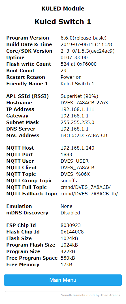

Thank you for the great replies, I had to work a lot but I finally got things going! I had made a few mistakes which made the issue difficult to track down.
This was my first clue, I had originally watched a video on the subject and the person was using the fallback topic. I wanted a unique topic for my devices so I chose to do the same.
Thanks for the great tool, I wish I knew about this 2 weeks ago! Using it I discovered Tasmota devices do not publish on the fallback topic, hence why I wasn’t ever getting updates. So I changed my Topic to the client ID.
This makes the Full Topic unique across all my devices (unless there happens to be a collision with the MAC addresses).
Took me a while to actually see it, sometimes it works even though I didn’t use the correct case for sending a command, the other way around is not so lenient. So I switched my Things file to my new Full Topic and correct-case command.
Bridge mqtt:systemBroker:embedded-mqtt-broker
	Thing topic Test_Switch_Thing "Test Switch Power" {
		Channels:
			Type switch : Test_Switch_Channel_Power  [stateTopic="stat/DVES_7A8ACB/POWER", commandTopic="cmnd/DVES_7A8ACB/POWER"]
