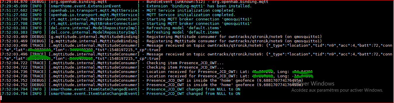

I’ve search a lot on the new mqtt 2.x created recently and use it for my renew installment and it’s awesome but…
Trying to make work my Mqttitude is not working at all.
It’s look like mqttitude 1.x is connecting properly to my local mqtt via the new mqtt V2 but it do not receive any updates… should I make an Channel for it !!?
So on last resort I’ve finally install Mqtt V1 addons with another mqtt connection name and everything fire up as perfect “regions, manual home, ect…”
How should I proceed to subscribe properly old Mqttitude V1.x to new MQTT V2.x ???
Tank you for all your wonderful work! Looking forward to remove obsolete mqtt binding

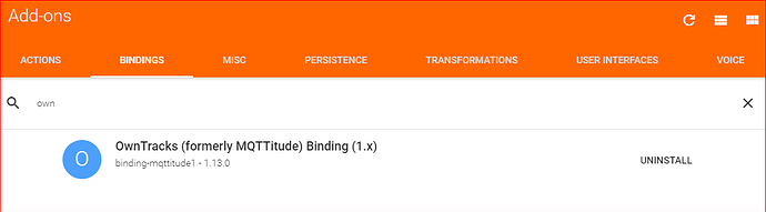

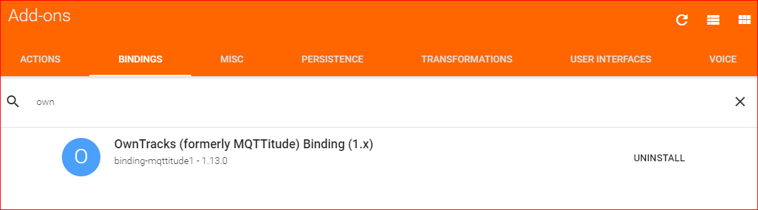

As far as I remember there is a replacement binding that calls itself differently now. But forgot the name
Owntracks.
yes… same addons same version both name
One binding exist for name owntrack or mqttitude no V2
