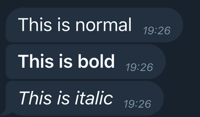

Okay so after give this snapshot a try, it works so far I have tried it with Bold and Italic.
so anyone have an idea how to try and get the text formatted ?

you need to use this snapshot for telegram, from this post, and rename the *.pdf to *.jar and but this in your add-on folder. New Telegram Action
that you have to adjust your telegram.cfg like this
telegram.bot2.parseMode=Markdown
