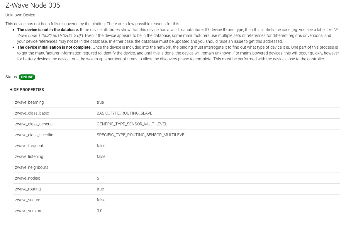

I have problems with my Aeotec Multisensor 6 as it is not recognised
Attached the screenshot from OH2.4
Any idea? I can’t upgrade the firmware as I’m running Mac and the upgrade utility requires windows.

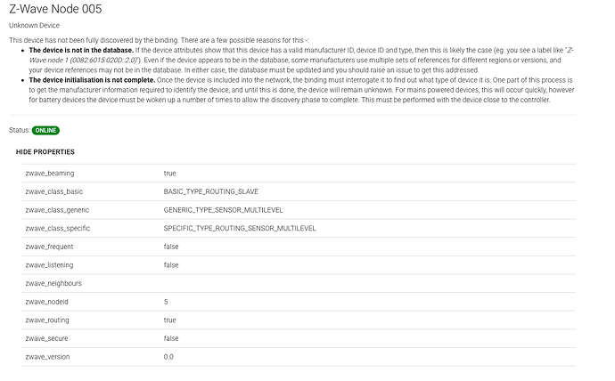

I had lots of trouble to get this one recognized also.
I had to manually wake it up 10 times
It was recognized afterwards
Thanks for the hint.
I connected to a USB port and push the button in the back and that made it work.
careful because: it makes a difference on how you include this node to your Z-Wave network
if you include it using power: it will stay on all the time and report much more frequently
if you include it using battery: it will go to sleep and awake on a pre-defined period and report less frequently
if you include it using power and then swap to batteries: it will kill your batteries
This is about inclusion to the Z-Wave USB Stick, not to the Z-Wave Binding though
More info on: Difference between USB and Battery Power and Recommendations (Multisensor 6 ZW100) : Aeotec Help Desk
edit: If you had included it in your Z-Wave network using batteries and then used power to help it wake it up, you should be ok since it is using the “battery” profile… not 100% sure about all of the above ![]()
