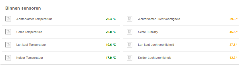

Seems I have lost my default ICON set and icons like temperature and humidity will give an empty result in my basicUI. To be honest my sitemap does not show any icons apart from icons defined in the folder “/etc/openhab2/icons/classic” starting with “self…”. Think I found the iconset on internet (GitHub - eclipse-archived/smarthome: Eclipse SmartHome™ project) but unsure how to fix this.
How can I get the default icons available again? Any ideas?
