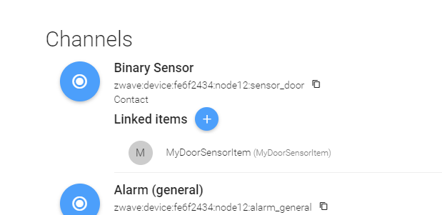

I created an item and link it to the channel as in here:
I created a new rule as in here

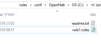

The rule is in this folder:
Thanks in advance.

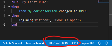

I can see it’s UTF-8 with BOM, and it’s CRLF, not LF.
Nope, that’s discourse auto changing when code not marked as code :wink:
No, in post 4 his rule is marked as code but there are wonky quotes

You don’t need Visual Studio but Visual Studio Code (that’s another software) Get it from here:
It’s free. There’s a plugin for openHAB (can be installed directly from Visual Studio Code builtin market place).

As I’m using VSCode, it’s one click to change the behavior :wink:

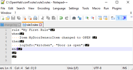

I installed notepad++
Changed it to LF, Utf-8 without BOM.
Still same error :frowning:
But now the file is named rule3.rules, not rule1.rules. Is the error about rule3.rules?
I use Notepad++ as well. I have never seen this LF in my files.
Perhaps create a whole new file starting all over could be the fix.
