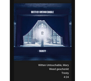

thanks for your reply :wink:
even if it surprises me a bit…
as you can see in my screenshot it was working when I developed the custom widget.
I must admit, initially I used the JS conversion as pattern and not the other one to be honest…
but if you’re right and this wouldn’t work at all - the only possibility would be that the Item itself converted it, as you stated above if I get that right…
A few weeks ago I converted my items from files to UI, so I’m not able to confirm this…
What I can see is that none of my UI items have a conversion scheme in the ā€œnameā€ now.
