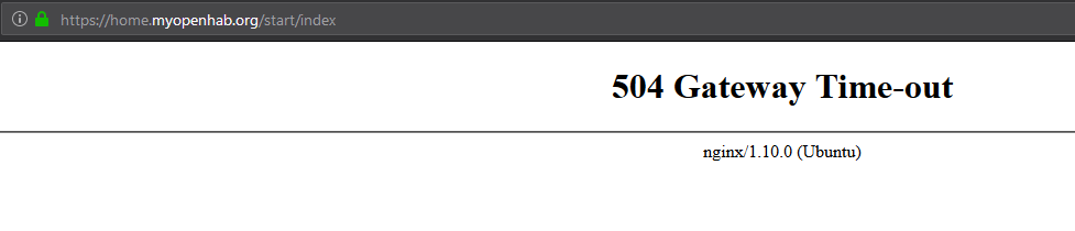

@digitaldan myopenhab.org is working again, but https://home.myopenhab.org/start/index is still not reachable…
My instance is working now.
Alexa is working too.
If others can confirm this, then i will tag the thread-title with SOLVED …
here it work ![]()
Yes, is working perfectly!

@digitaldan: are there any new news? i have the same problem as @Thomas_Ihmann since last thursday. myopenhab-login works but i cannot open the dashboard => 504 Gateway Time-Out

@Thomas_Ihmann is your dashboard reachable again?
