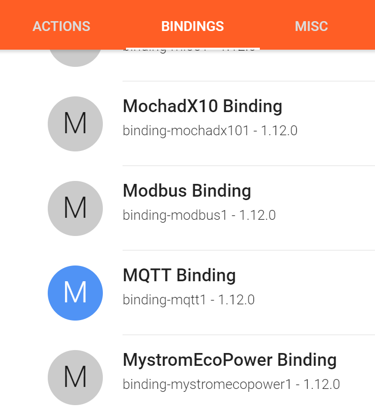

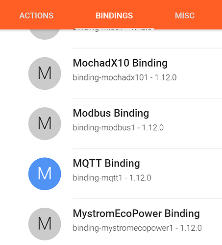

As the title says, I used to have Mysensors binding installed and working on 2.2 stable.
When I upgraded to 2.3 the binding got uninstalled and no longer find it in the bindings list in paperUI
Am I missing something ?
Regards
Edit: Apparently the Eclipse IoT Marketplace was also uninstalled. As soon as I installed it again the binding appeared back. Hopefully this saves somebody’s time
