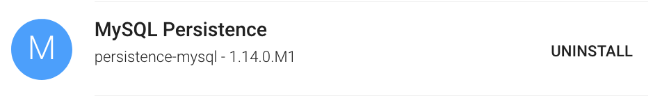

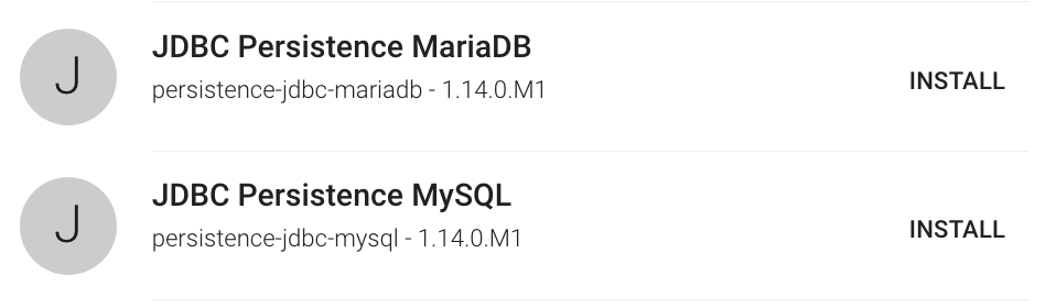

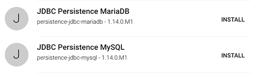

I think, I still use MySQL directly and no JDBC as PaperUI shows only:
