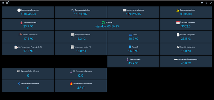

Here is the result
You might be wondering why widgets are so wide, but that was for now the only solution that it stays readable on PCs, TV, and phones.
I turned on Phone compatibility in setings and turned widget height to 110% otherwise text goes out of border on Phones wheh in landscape and on TV as well.
Do you maybe know any better solution to make it look more similar on diferent devices..I’d appircate it.
