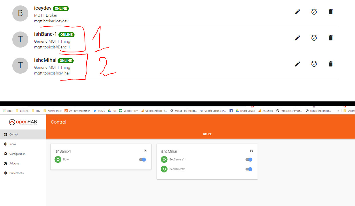

I have configured 2 ESP8266 with tasmota to control 2 set of lights. Added them on Configuration → Things.
The problem is when both are online i can’t control them from the Control Panel. It gives the instruction to power ON but it does nothing. If i power off one ESP, the other one works.
This is the Log file

I can control the ESP from the http but not from the openhab when they are both online.

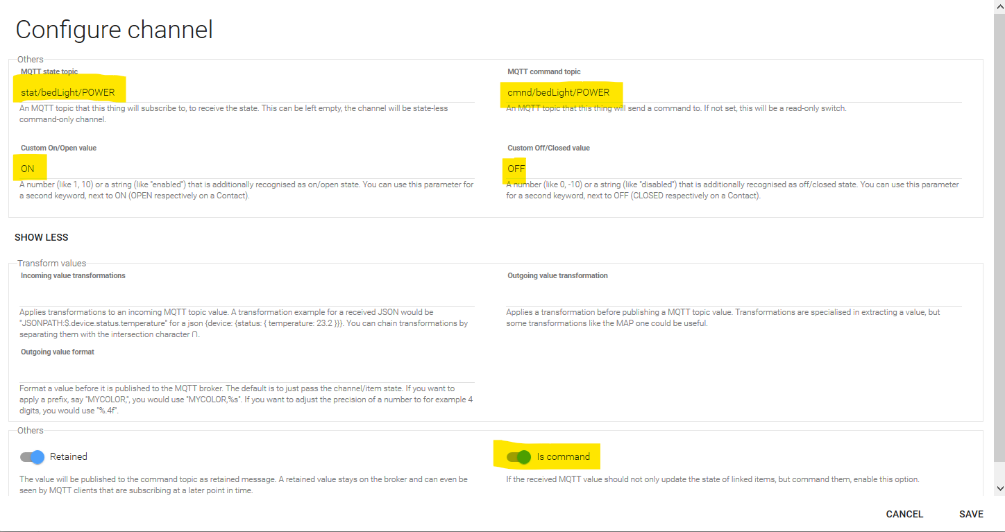

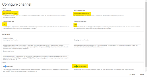

I’m not sure what exactly is your issue, nevertheless I can show you how is set one of my sonoff switches, : this is Switch channel in sonoff Thing
You need to define state and command topics - if you did not change topic settings after Tasmoata installation than it will look like in my picture - you need to change “bedLight” word to your topic.
Hope it helps.

Each and every MQTT client needs ist own ID. If you have two Clients with the same ID such Problem could happen.
Using Tasmota you can set the MQTT client ID on the webinterface.
ooohh, i didn’t know that…now they work <3
thank youu
Hello, Thanks for the info :D.
The problem was with the client id, it was the same in both devices.
