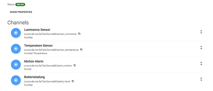

In the new binding, the sensor shows only 4 channels:

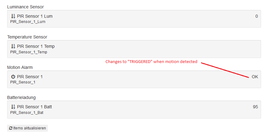

The channels “sensor_luminance” and “battery-level” deliver the same values as before and work fine. As the channel “sensor_binary” disappeared, I thought ok, let’s use “alarm_motion”. So I changed my item config to:
Switch PIR_Sensor_1 "PIR Sensor 1" {channel="zwave:device:3a7e4c2a:node8:alarm_motion"}
But this Item now only fires an event when thing is updated, when doing so, it changed to “ON” in eventlog, but not back to off. And also not reacting to motion detection.
And even more strange: When watching this channel in HABMIN, the channel “alarm_motion” changes states when motion is detected:
But this change is not reflected into the associtated item state changing. No entries in event log when motion detected.

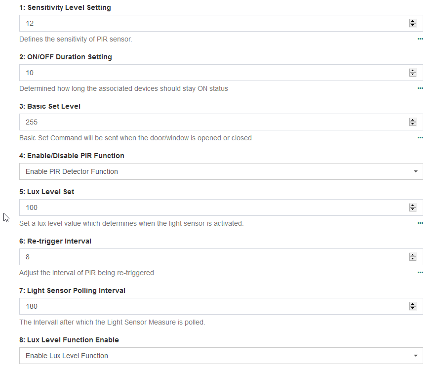

Configuration of the device (not changed since using it in 2.3):
