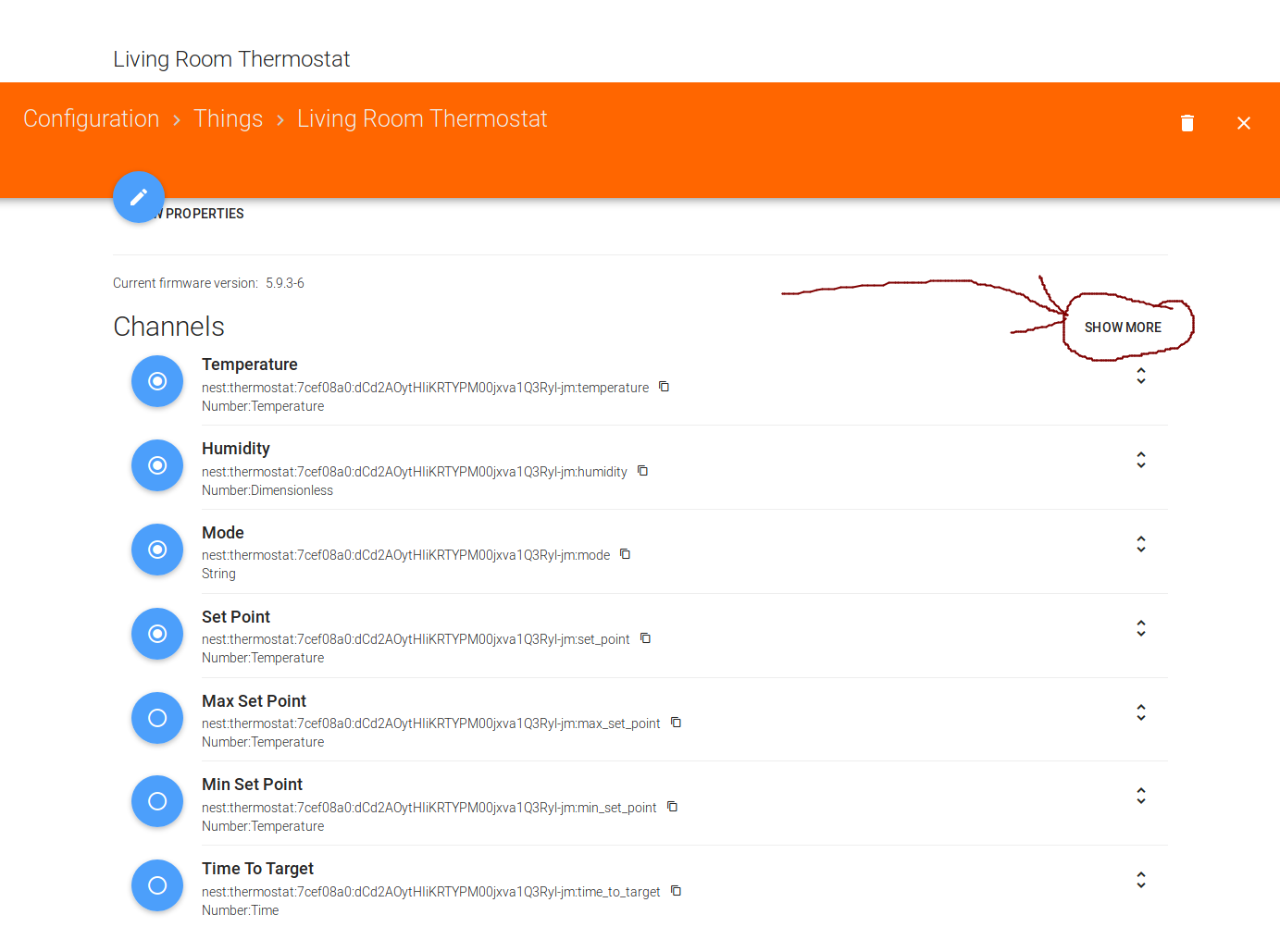

Yes, that it normal behaviour.
Can you post a screen shot of the channels of your smoke alarm, please?
Did you try to click the SHOW MORE button on the top right?

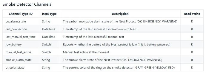

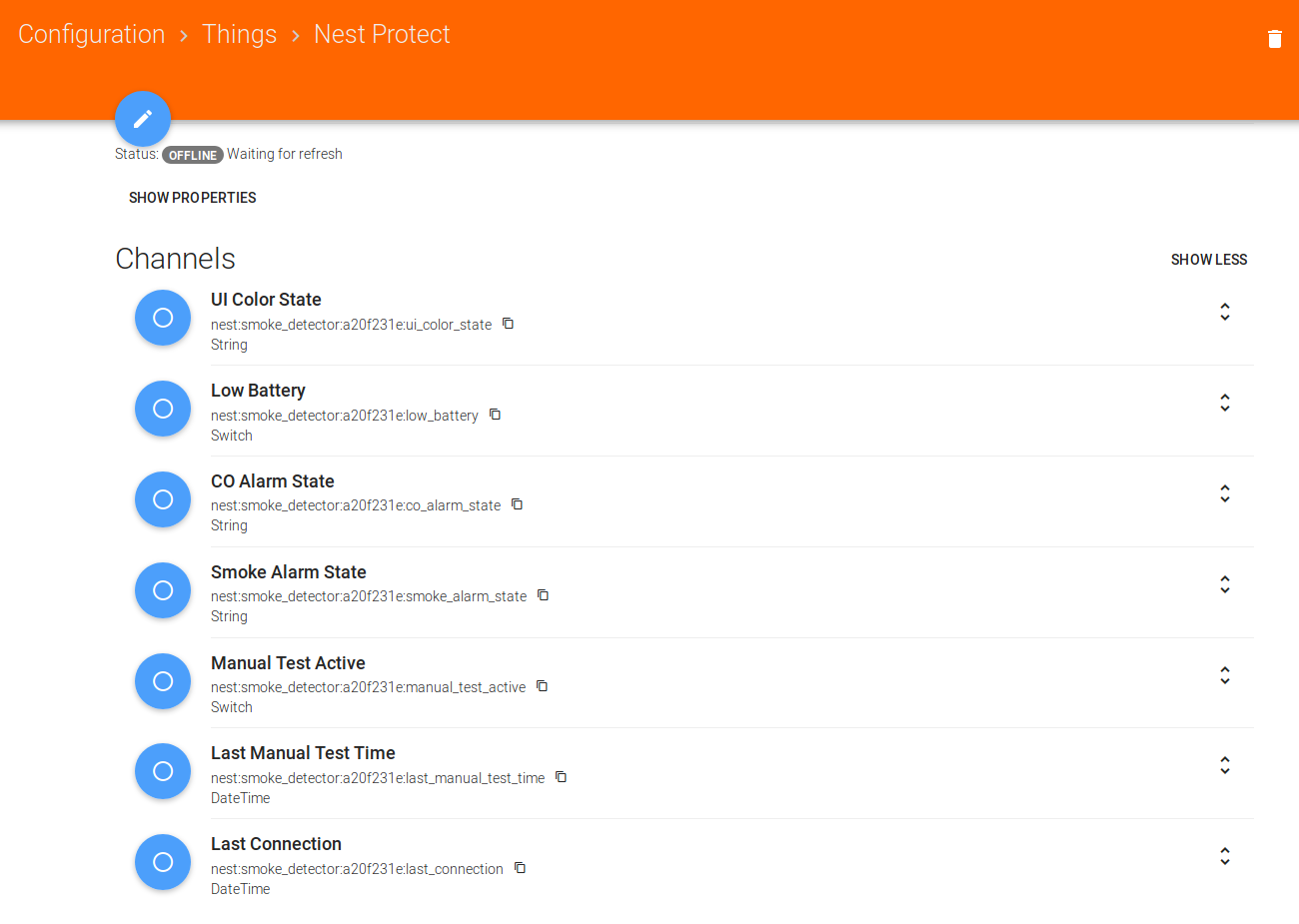

Stupidly I didn’t click on show more however I have done now. It only shows 5 channels, not the 7 listed in the documentation.
I have 7 channels:
What version of OH are you running?
2.2.0 on a QNAP NAS. It’s the latest that I could find on the link from the OH documenation.
That will be why.
Check the forum if there is a way to update to 2.4 on your hardware
Good luck
You know i’ve been looking at this documentation for days and have only just noticed that 2.2 only has 5 channels. I have found a version of 2.4 too so fingers crossed for a fresh install.
Will report back. Thanks for your help so far. Sorry for the silly questions!!:thinking:
