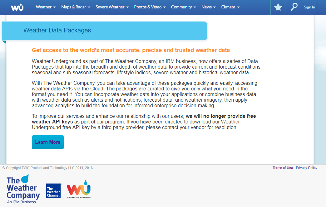

WeatherUnderground is no longer freely accessible and the other providers calculate the weather mainly for an American model, which does not really fit for Europe.

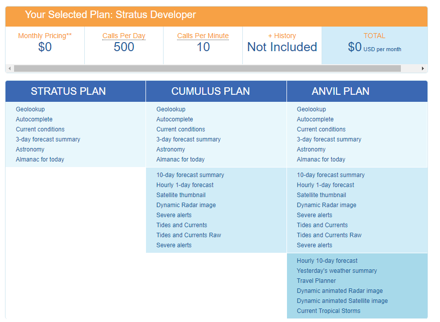

it is… i’ve been using this for a couple of months… and it works great… you are just limited to 500 API calls per day and 10 API Calls per minute…
This is from https://www.wunderground.com/weather/api/
This is a relatively recent change in policy. Only those of us who acquired an API key before the change in policy have an API key and have access to the free plan. For now at least.
I am afraid that is not possible. AFAIK none of both provides a public API.
oh sorry… ok that was new to me… thanks for this info…
so hopefully we will be able to use the data in the future for free… but its better to look for alternatives…

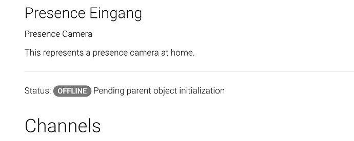

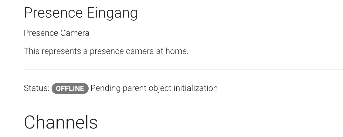

i would like to test the new Netatmo Binding. But i’m struggeling in setting up the binding. is there a short howto available how to get the binding working?
i see only this information:
Status: OFFLINE Pending parent object initialization
BR Dave
Good morning,
Did you add the Home Thing first? I see a main problem here and will to change this behavior to a more independent and generic one but for now try to add the home first
