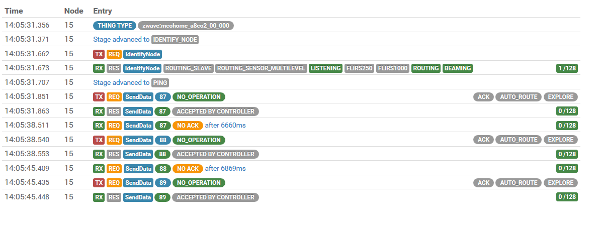

I don’t think data is ever received, though; at least, is what these logs make me believe, since there are literally lines that say “No data from device”.
I tried to glue together as much logs as possible over the course of two minutes, more or less; after that, “NODE 15” no longer appears in them. The sensor itself is measuring stuff, however I don’t see any of those values among the logs. Here they are.
mco_logs_3.txt (361.7 KB)
Do not filter logs. They are useless for troubleshooting. Debug logs after stopping and restarting the bundle in Karaf can be useful though.
I don’t think this log is filtered - or if it is, it is probably still ok. What this indicates is that the device is not responding. The binding is sending out a PING message, and the device doesn’t respond (ie NO ACK). I would reset the device and re-include it. Alternatively, if you think it’s out of range, then move it closer to the controller.
Sorry @Bruce_Osborne, I just meant that I copy-pasted logs as they were overwritten by new logs; I did include all information that was provided to me in those 2 minutes, so no filtering was done on my part.
@chris ok, I’ll try resetting it; as for range, if this sensor could not communicate with a controller two inches to its left I would be very disappointed in MCO Home products :rofl:

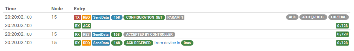

If it’s of any use, here’s a log of when the MCO Home sensor is found by discovery and put in the Inbox. I don’t know if I got it from the beginning though. (Now the device is called “NODE 16”)
mco_logs_inbox.txt (279.1 KB)
Nothing on the re-initialization part, I’m afraid. Still no ACK from the device.
