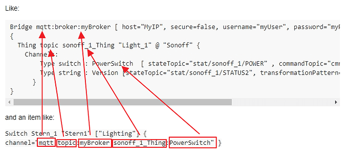

I need a little on this one - it should be fairly simple, but I cannot figure out why it isn’t working.
The issue is I can’t see the temperature in my sitemap with the new MQTT 2.4 binding
This is my config :
Things
Bridge mqtt:broker:mosquitto "local mosquitto" [ host="localhost",secure=false ]
        Channels:
		Type number : MQTT_BoilerRoom_1_1  "Flow"  [ stateTopic="/ESP_Easy_BoilerRoom/OneWireBus1_1/Temperature" ]
Items
Number  Temp1  "Temperature"  {channel="mqtt:broker:mosquitto:MQTT_BoilerRoom_1_1"}
Sitemap
Text item=Temp1	label="Temp1 [%.2f °C]"
In the openhab.log (and paperUI) I can see that the broker is online, and in the events.log I see events regarding receiving temperatures. I guess this indicates that the binding is working as expected, and the issue is related to my item/sitemap config, but I cannot figure out what I’m missing ?
openhab.log
2019-01-01 21:07:10.250 [me.event.ThingUpdatedEvent] - Thing 'mqtt:broker:mosquitto' has been updated.
2019-01-01 21:07:10.329 [hingStatusInfoChangedEvent] - 'mqtt:broker:mosquitto' changed from OFFLINE to ONLINE
2019-01-01 21:07:10.330 [me.event.ThingUpdatedEvent] - Thing 'mqtt:broker:mosquitto' has been updated.
events.log
2019-01-01 21:28:07.413 [vent.ChannelTriggeredEvent] - mqtt:broker:mosquitto:MQTT_BoilerRoom_1_1 triggered 27.87
Any ideas ?
/Lars

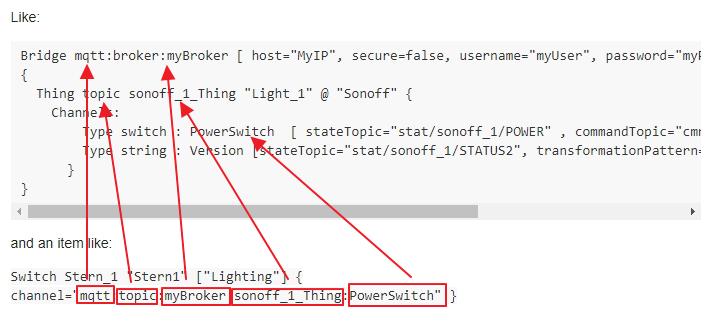

You did create a broker thing, after that you need to create a ā€œGeneric MQTT Thingā€.
Like:
Bridge mqtt:broker:myBroker [ host="MyIP", secure=false, username="myUser", password="myPassword" ]
  Thing topic sonoff_1_Thing "Light_1" @ "Sonoff" {
    Channels:
        Type switch : PowerSwitch  [ stateTopic="stat/sonoff_1/POWER" , commandTopic="cmnd/sonoff_1/POWER", on="ON", off="OFF" ]
        Type string : Version [stateTopic="stat/sonoff_1/STATUS2", transformationPattern="JSONPATH:$.StatusFWR.Version"]
and an item like:
Switch Stern_1 "Stern1" ["Lighting"] { channel="mqtt:topic:myBroker:sonoff_1_Thing:PowerSwitch" }
Hi Jürgen
It works :partying_face: :+1:

Hi Jürgen
First of all thank you for your help, things are working now (thanks to you), but now I would really like to understand what I’m doing :thinking:
On this page MQTT Arrives in the Modern openHAB 2.x Architecture | openHAB the thing-syntax is described with a colon (and a mqtt: in the beginning) Thing mqtt:topic:mything and you have spaces between Thing topic sonoff_1_Thing - do you know if both are valid, or is it just a typo on the blog-page?
Your example has Light_1" @ ā€œSonoffā€, which the example on the doc page doesn’t have MQTT Things and Channels - Bindings | openHAB - what is the purpose of Light_1" @ ā€œSonoffā€ ?
And last but not not least.. the channel part of the item is a ā€œlittleā€ confusing - it looks like its a mix something from ā€œbridgeā€:ā€œthingā€:ā€œbridgeā€:ā€œthingā€:ā€œchannelā€ - i can’t find any documentation about channels in general. Do you know if its described somewhere, or can you explain it ?
I have tried to visualize it with this image
