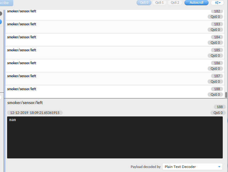

I loaded mosquiito.exe and connected mqttfx, what do I need to setup in mqttfx to see the values, then what gets done in OH
Update: So I got the data coming into and showing in MQTTFX, now the question remains for proper OH
setup
