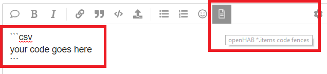

first of all, please edit your post above and include all code in fences
it’s easier to read the logs and entries
Yes, that does look a lot better!
