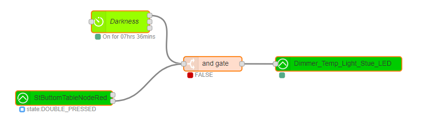

I’m trying to make my first node-red rule to test it out. My flow looks like this:
I’m using the “node-red-contrib-bool-gate” to make an “AND” check from the raw object from my xiaomi buttom:

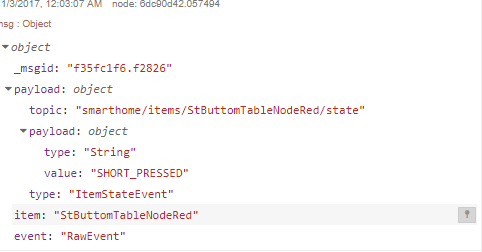

I need a topic and msg. to a value to make it work. From the debug I have:
I need to give the topic which I think is “smarthome/items/StButtomTableNodeRed/command”
and the “msg.” path to “SHORT_PRESSED” which I think is : “msg.payload.payload.value” but I can’t make it work.
Please help:!

The topic here based on your output should be “smarthome/items/StButtonTableNodeRed/state”. From the top of my head you should have the msg.payload.payload.value" correct to pull the payload.
I haven’t used the bool gate nodes so don’t know enough about how they work but should probably take a look. I accomplish what you are trying to do by having the BigTimer set a global flow variable which I check when my action occurs using a switch node.

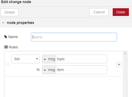

@rgerrans I tried your suggestions, but it still doesn’t work
p
I found if I use channel 1, and use the change function I can make it work like this:
But then I would need to add a change for every AND node
Yeah the code gives some problems with the preformatted text function somehow, but thanks, I found that adding the topic works, but if I could avoid this it would be nice.
find out what topic your current items are sending. And add those to the AND gate?
I would like to be able to get the topic and value directly from the item and use them in the gate function.

With the raw channel, there is no topic at all. I think I need an other approach, thanks a lot for you assistance.

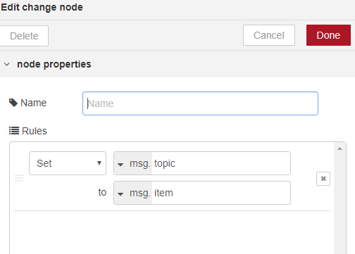

It’s been way too long since I used the raw channel. Try using a change node to move msg.payload.topic to msg.topic.
Or another guess would be to use a json node to convert it but I don’t think that’s right. If you don’t get it working today I should have some time this weekend to reininstall the OH nodes and play with it.
You can simply add a topic
Example.
