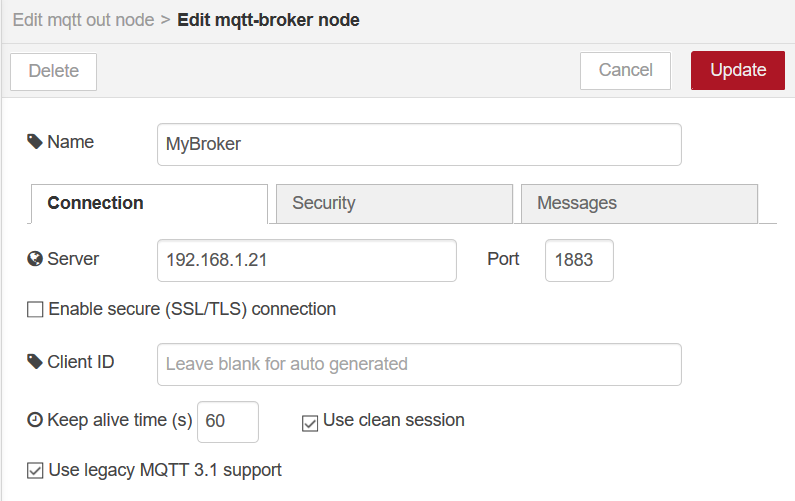

I don’t know NodeRed, but I do know that each client must have a unique clientid. But as long as they are unique, they can be anything.
Is your broker thing showing as connected?
Thank you Rich, you are right ClientID was not defined into Node Red now this done, but still not changing value.
And yes both Broker and generic are showing online
Is there any documentation specific to this or may be a full and detail exemple from soneone ?
Many thanks
Pef
What is the correct clienID in openhab2 with generic thing ?
MyBroker or MyBroker/MyMqtt or something else ?
The client is not relevant for openHAB. Only for the broker. openHAB only revceives topic changes.

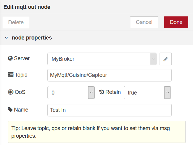

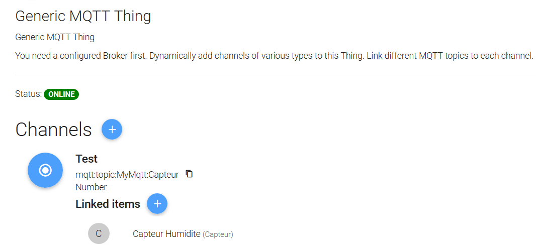

My mistake here was mainly due to I was thinking I had to define full path into topic Node red configuration, but in fact you only have to put what you define into you channel configuration
MQTT state topic & MQTT command topic (ie “State” is only for testing, I guess when you have multiple channels you need to be more organized and specific) in my case both has to be identical (I tried for instance State and Set but could not make it work in Node Red)
Mqtt Input config
Mqtt Output config

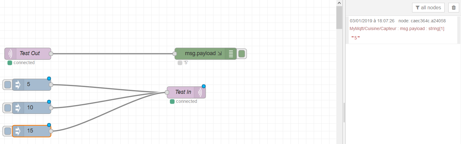

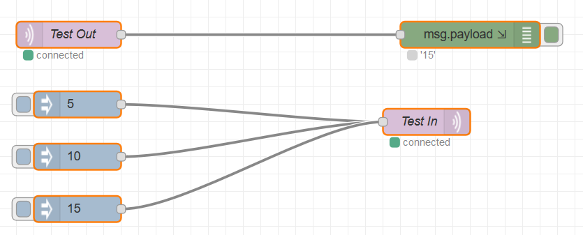

Other misstake I made earlier was inject number instead of string
So now I can change and receive value of my number from HapPanel ↔ Node Red thru Mqtt
