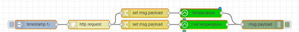

I figured out how to poll the API and populate the items:

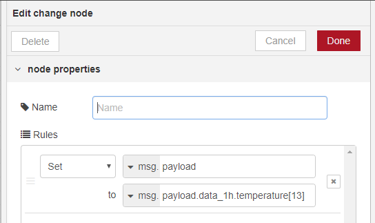

Here is the node that writes the data at 1pm (13:00)

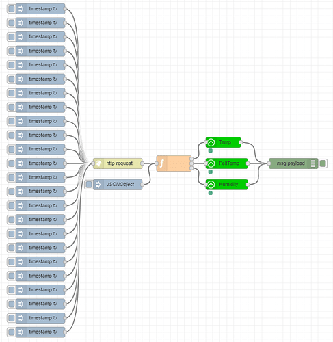

To cover all 24 hours my only idea is to copy this flow 24 times and start it at every hour with the corresponding array values “hard coded”:
payload.data_1h.temperature[13]
payload.data_1h.temperature[14]
payload.data_1h.temperature[15]
etc…
Is there any better way to handle this? I am thinking about a variable that is checks the current hour and is used in the payload.
e.g.
payload.data_1h.temperature[VARIABLE]
I hope I explained myself well enough as I am new to nodered and APIs :slight_smile:

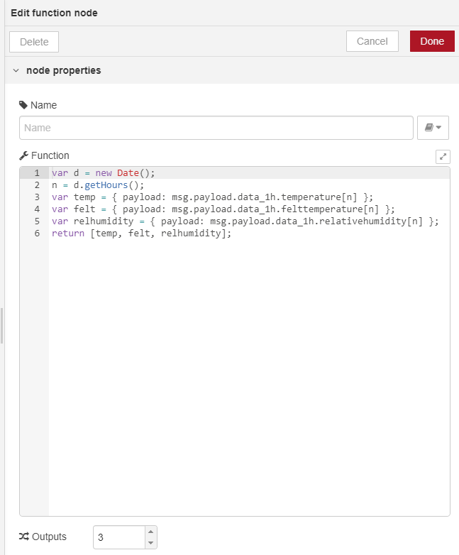

I am trying to get this optimized with the function node. Do you think this will work conceptually? I am not sure about the right syntax for the variable n in the
var d = new Date();
n = d.getHours();
msg.payload = msg.payload.data_1h.temperature[**n**]
return msg;

I made it finally work. Here is the solution:
var d = new Date();
n = d.getHours();
var temp = { payload: msg.payload.data_1h.temperature[n] };
var felt = { payload: msg.payload.data_1h.felttemperature[n] };
var relhumidity = { payload: msg.payload.data_1h.relativehumidity[n] };
return [temp, felt, relhumidity];
I use 24 trigger actions to make sure the flow is processed exactly at the same time every hour.
