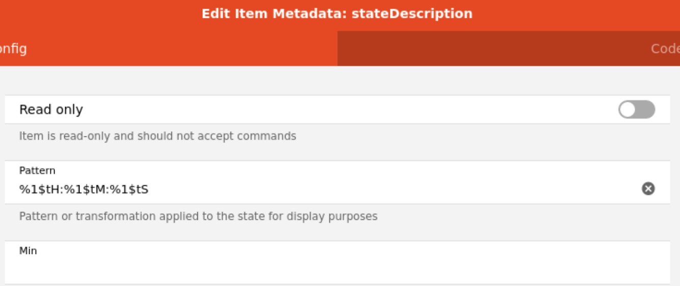

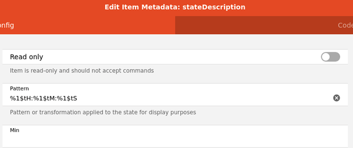

What type is the duration Item? If it’s a Number:Time you can use DateTime formatting on the Item’s State Description metadata to show hours:minutes:seconds (or what ever you prefer) and in your widget you’ll use .stateDescription instead of .state. Note that .stateDescrption only exists when the Item has a State Description metadata defined.

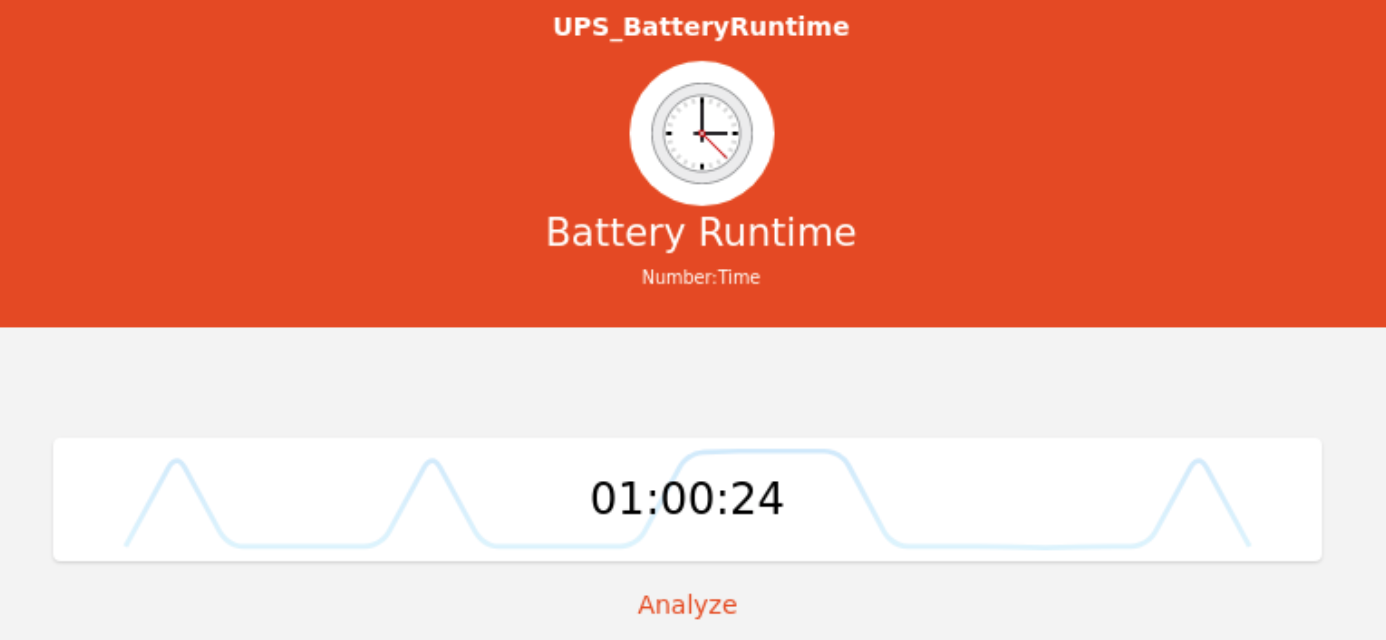

As an example here is the runtime of my UPS which is a Number:Time.
Yes because if it’s just a plain old number what I presented above won’t work. If you can convert it to a Number:Time that would probably be easiest as then you can use the state description as written above.
If not, you’ll need to create a JavaScript transform to do the operations to split the seconds out into hours:minutes:seconds (there are lots of examples on the forum). Then in the State Description metadata you’ll call the transformation just like you would do in a label on the sitemap.
JS(fromseconds.js):%s
Overall, the tl;dr is you can’t do this inline in the widget. You have to do it in the State Description metadata for the Item and then in your widget used the formatted state by calling .stateDescription instead of .state.
