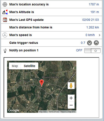

However, when I arrive at whatever destination, and a short while later, the map does not show the location pin on the map; in fact it does not show a map at all… while the map and pin are there while updates are sent.
Has this got to do with sitemap updates?
What I noticed in REST is the item holding the coordinates is empty, after a few seconds.
Considering that a location message is only sent every so often, why is this item set to undefined and thus clearing the map?
2019-09-02 21:06:52.817 [vent.ItemStateChangedEvent] - GeoLoc_MaxG_Coord changed from -25.82441125122754,151.8969802675012 to undefined,undefined

Huh… was also revisiting my persistence business, as in not using groups, but explicitly adding items to the rrd4j group.
Adding the item to persist brought the map back up with the last recorded value! :slight_smile:
