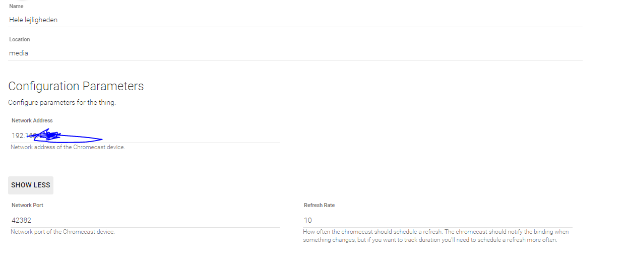

Never mind, found how to get port number and followed your guide, now all seems working fine.

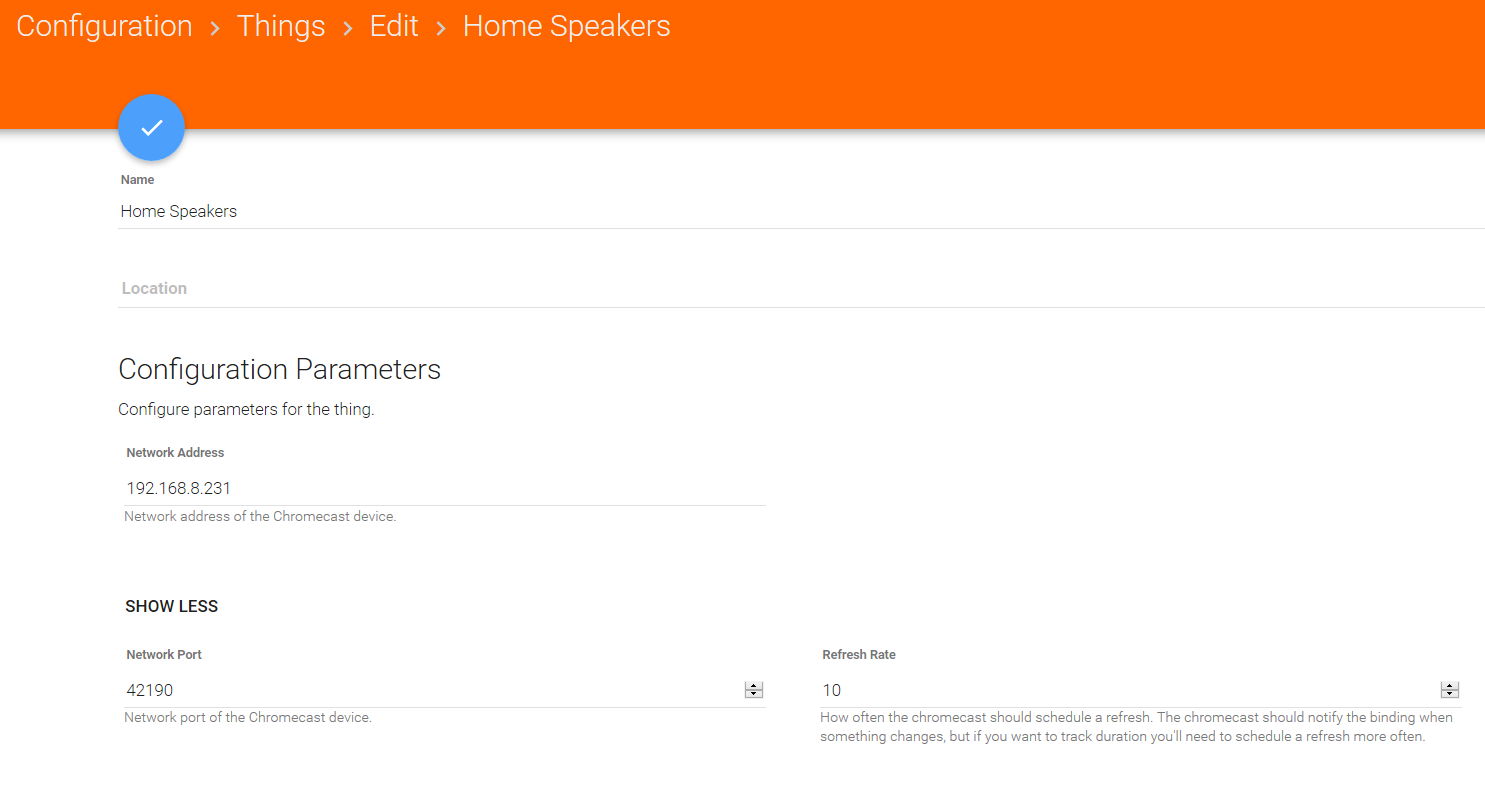

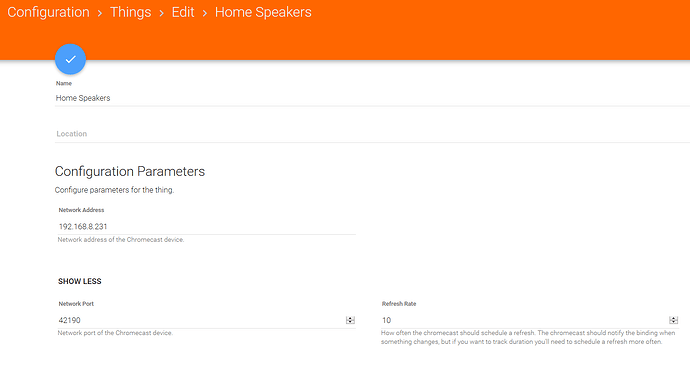

First create your speakers group using your Google Home App on your mobile phone. Once done, go to openHAB paper UI → inbox and scan for the new things. Your speakers group thing will appear there, now you need to add it. Once added, now navigate through your things in openHAB, find the speaker group you just added, click on it, then press edit the thing and click on show more section, you will see it as in the screenshot below:
To add it to your .things file as an audiogroup, you can do that as the following:
chromecast:audiogroup:HomeSpeakers "Home Speakers" [ ipAddress="192.168.8.231", port=42190 ]
The IP address 192.168.8.231 is the IP address of your speakers’ group that’s elected once the speakers group is created.

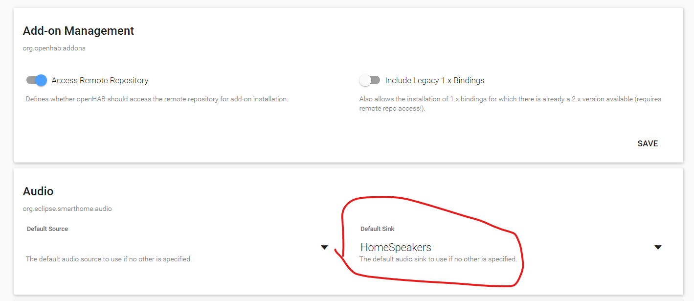

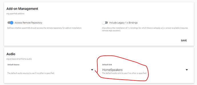

Once all of this is done, go to Configuration → System and select it as your default sink:
