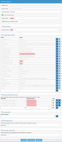

in openmediavault docker config for openhab2:
Did I am missing something? Can I use the Port 8080 for this?
Greeting
It looks like you’re using the same directory for all three volumes? That won’t work. They should all be different directories. Using spaces in volume paths is also asking for issues. :wink: There will also be logging telling exactly what the issue is.

These environment variables are passed to the container when you start it. I think it should work if you add those as new entries to the “Umgebungsvariablen” list in the screenshot.
