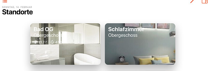

I am searching for the right way to set an opacity on an image of a location label card.
This does not seem to work:
  OG_Bad:
    - component: oh-location-card
        backgroundImage: /static/Badezimmer1.jpg
        style:
          postion: absolute
          opacity: 0.5
        badges:
          - windows
          - temperature
I don’t know about opacity but you can adjust the brightness.
            backgroundImage: /static/garage.jpg
            backgroundImageStyle:
              filter: brightness(60%)
60% has worked well for me.
Thanks Rich, that is what i was searching for!
