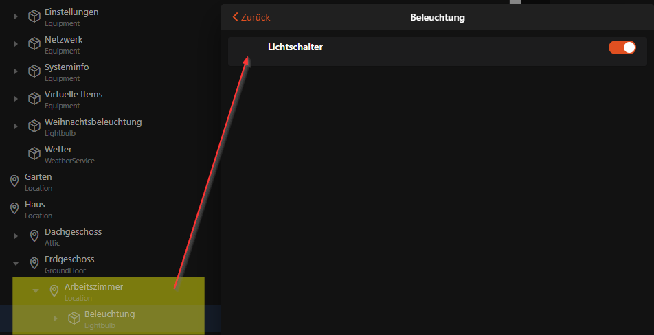

I needed to reboot OH due to an error. Now I don’t see a lot of icons anymore:
There should be a lightswitch.

If I go to the group “Beleuchtung” in the location “Arbeitszimmer”, I see the same:
Thanks for your help
EDIT: Due to my crash it seems that some bundles were disabled. One of the was the icon set:
After starting the bundle again, the icons are back now.
