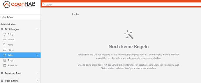

There was one thing I couldn’t get right after migrating to OH3. I cannot create rules, scripts and schedules.
When I try this, I get on the first attempt (in the log):
00:46:36.680 [WARN ] [automation.rest.internal.RuleResource] - Creation of the rule is refused: null
And on the 2nd save attempt:
00:49:23.986 [WARN ] [automation.rest.internal.RuleResource] - Creation of the rule is refused: Cannot add element, because an element with same UID (5130d50f0c) already exists
However, the rule is not saved - or at least not visible
2020-12-26 01.52.52 192.168.100.10 f7b86756ab90
Does anyone have an idea?
Greetz,
Christoph

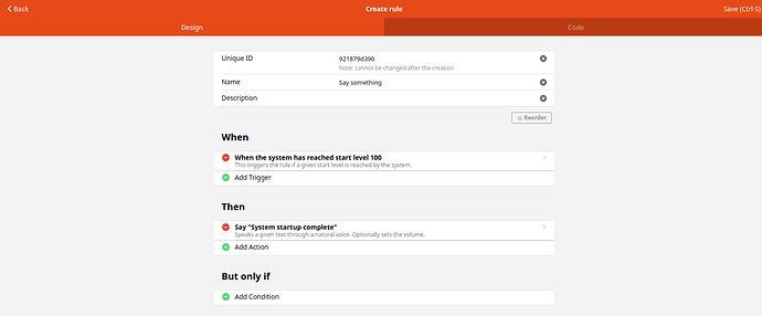

As you see, the rule ID is the same like here:
2020-12-28 22.46.10 192.168.100.10 a0622b652103
It seems the the ID is created, the trigger as well but no action. At least this explains the error message saying that the rule already exists.
Maybe this helps a little to ivestigate what’s going on there. More and more I’m convinced that I experience a general bug here…
