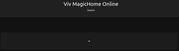

If I look in the Items page I can see the state just fine
but if I open the item I can’t see the state
Pages
I get the same lack of state in the Pages UI as I see in the Item’s page

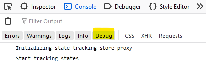

Please open the developer tools of your browser, go to Console and activate the Debug/Verbose log level, and copy what you have.
To enable the debug logs, in Chrome/Chromium and derivatives, open the last dropdown and check “Verbose”:
In Firefox and derivatives, click on the “Debug” button:

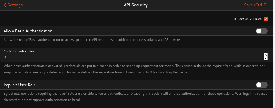

Actually, the issue is the Implicit user role for unauthenticated requests option. I had disabled it as it seems like the more secure option, but it seems it breaks the new UI’s ability to connect to the REST API as well.
Should I open a GH issue or are you already looking into it?
Yes this option is experimental and could break things currently. It shouldn’t be used except in very special circumstances!

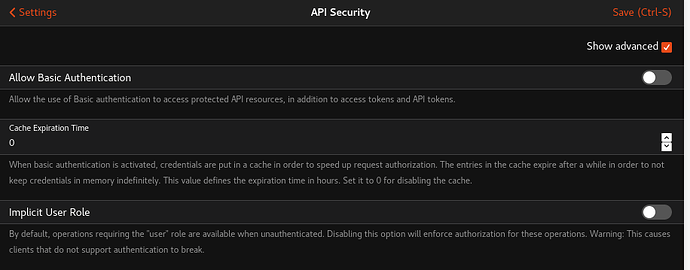

Any news with this? I have the same problem apparently and I don’t know how to solve it. My api security configuration is like this:
