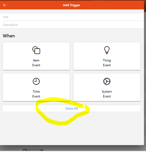

I would do a cronjob there you can do all your rules

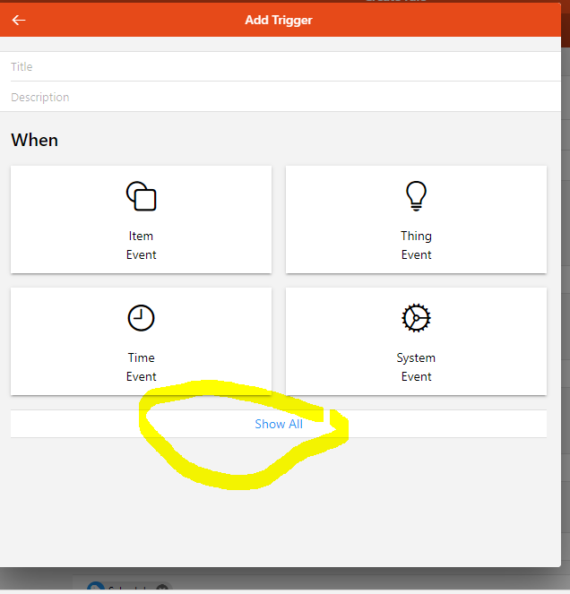

Click ‘Show All’

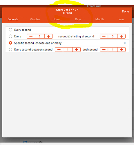

Click Cron job
Now you will se this bleow
And at top you se what it means
If you wish to see a description on cronojb its well defined
