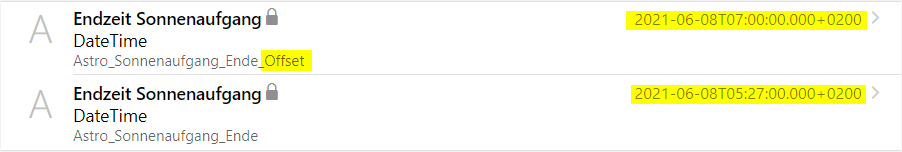

Now I would have expected the rule to run at the offset time of e.g. T07:00:00.000+0200 as shown in the screenshot above.
However if I check my log, the rule triggered at the original time which is T05:27:00.000+0200. Please see screenshot:
I also checked the events and saw, that they both happened at almost identical time:

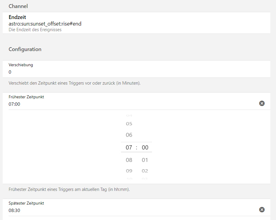

You both lead me to specifying an offset not just for the END/START but rather for the whole event. I don’t quite get, how this works just from a theoretical thinking (I get how to do it though). Maybe you can explain it to me.
If I apply an offset to END/START, it is quite clear, that it moves the actual point in time (e.g. START - 30 minutes) or specifies an particular statement for EARLIEST/LATEST. But how does an event be affected by this? An event is a duration like From-To, or not? How can you apply an offset to this time period? I do not get it, sorry.
The offset only affects the channel it’s configured on. If you would have linked an Item to e.g. the rise#start channel, that would display the original time without offset applied, since that’s only configured on the rise#end channel. Same goes for rise#event.

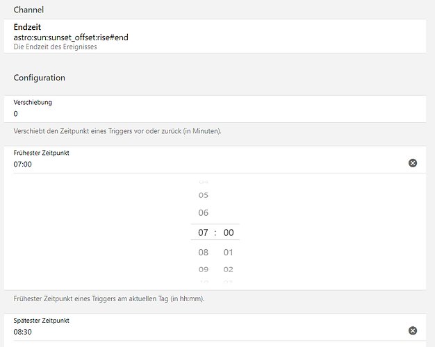

Okay, understood. But isn’t that, what I have done? I have specified the offset for the channel rise#end as you can see in the things-file (or also in the UI):
Type rangeEvent : rise#end [
                    earliest="07:00",
                    latest="08:30"
So from my point of view, this channel is specified adequately. Then I created a rule:

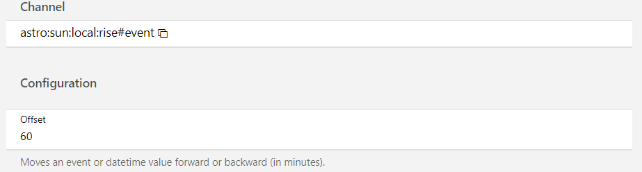

The rise#end channel has no offset configured, and displays the actual time of the sun rise.
However, the rise#event channel has an offset of 60, so it will always trigger 60 min after that time.

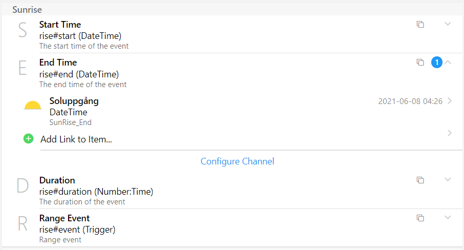

But rise#end is not an event channel. It is a state channel. You can tell this because you can link it to a Datetime Item.
At midnight, Astro binding works out times for the day ahead, and updates state channel rise#end to 06:30 or whatever. An Item linked to that channel stays at 06:30 until next midnight, nothing happens with it, you can’t use that for triggers.
Channel rise#event is a trigger event channel. It’s a completely different type, you can’t link it to an Item because it has no state at all. It just triggers events once in a while, events called START or END.

To apply an offset to the event
Type rangeEvent : rise#event [
                    earliest="07:00",
                    latest="08:30"
Note that you have to offset the whole event, you cannot offset START and END individually.
