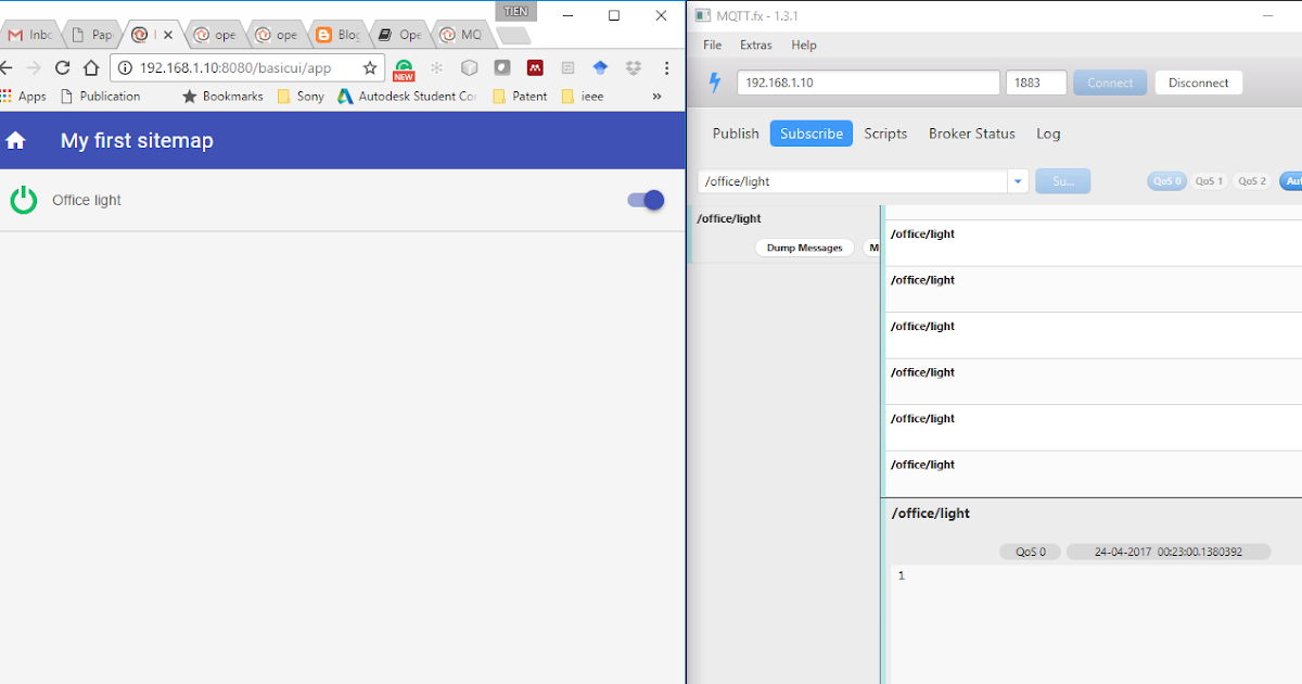

Have you added the items to a sitemap file and tried to control with BasicUI?
I didn’t followed this two steps
I will add sitemap & revert.
Thanks.
Hi there,
Finally get success.
I have uninstall mqtt binding 2.4
& Install legacy mqtt binding 1.1
Then I followed procedure as mentioned in below URL .
Thanks for providing help.
