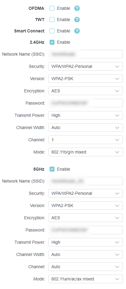

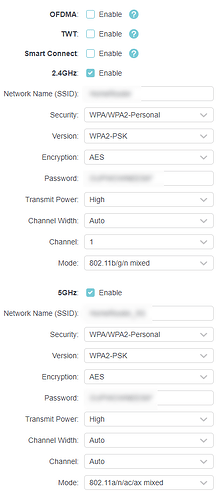

Regarding my problems with my MQTT devices (wifi), it was indeed due to bad configuration of my main router. After I fine tunned it, it seems to be perfect, even with so many devices. So I’m happy that my router can still handle this quantity of devices. :slight_smile:
Out of curiosity for those that might come across this, here’s my wifi settings:
