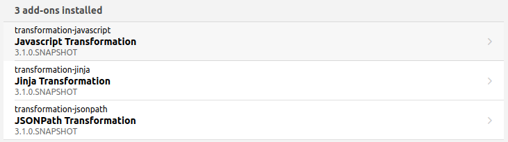

Do you have the JINJA and JSONPATH Transformation Services installed?
Yes,
233 │ Active │ 75 │ 3.1.0.202101150350 │ openHAB Add-ons :: Bundles :: Transformation Service :: Jinja
235 │ Active │ 75 │ 3.1.0.202101150350 │ openHAB Add-ons :: Bundles :: Transformation Service :: JSonPath

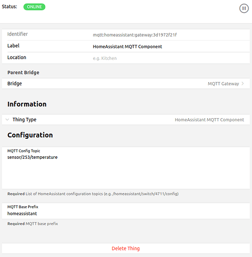

Here are the logs If I manually create HomeAssistant MQTT Component
20:19:04.833 [TRACE] [o.transport.mqtt.MqttBrokerConnection] - subscribeRaw message consumer for topic ‘homeassistant/sensor/253/temperature/state’ from broker ‘192.168.1.101’
20:19:04.837 [TRACE] [o.transport.mqtt.MqttBrokerConnection] - Successfully subscribed to topic homeassistant/sensor/253/temperature/state
20:19:04.838 [DEBUG] [hab.binding.mqtt.generic.ChannelState] - Subscribed channel mqtt:homeassistant:gateway:7f7891901f:253_5Ftemperature_5Fsensor#sensor to topic: homeassistant/sensor/253/temperature/state
20:19:31.863 [TRACE] [assistant.internal.DiscoverComponents] - Found HomeAssistant thing temperature component sensor
But not via auto-discovery.
Either this is a bug or you have to manually create the HomeAssistant Things like your log seems to indicate. It does say that it “Found HomeAssistant thing” so there is some sort of discovery going on. You wouldn’t see those logs if you created a Generic MQTT Thing.

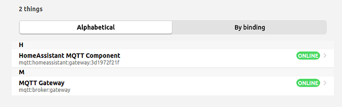

No, I did not create the Generic MQTT Think. but HomeAssistant MQTT Component as below.
So, did you create the Broker Thing?
Yes, below rite? Or, is it something else?

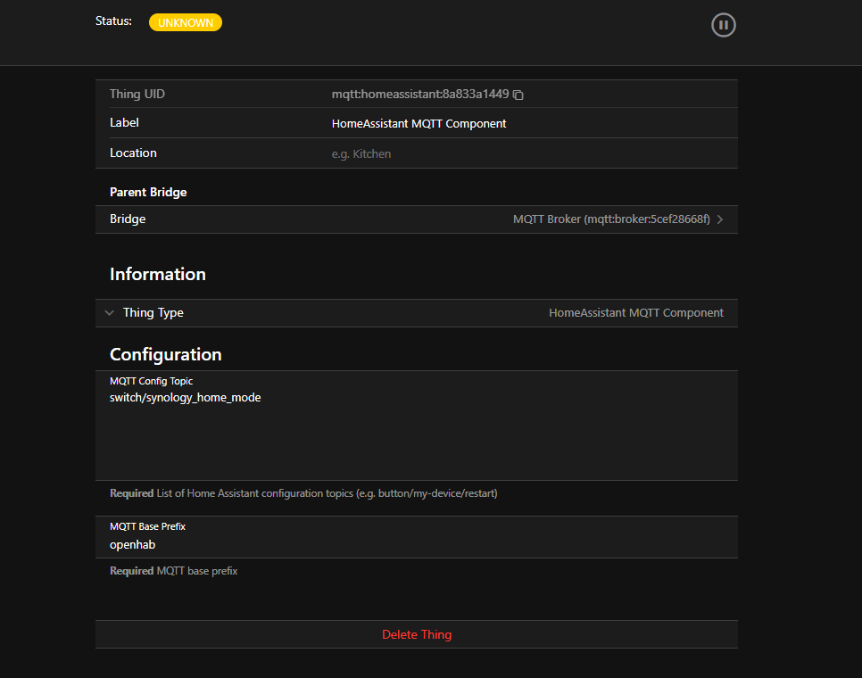

im new to Openhab, i setup an MQTT binding, its online:

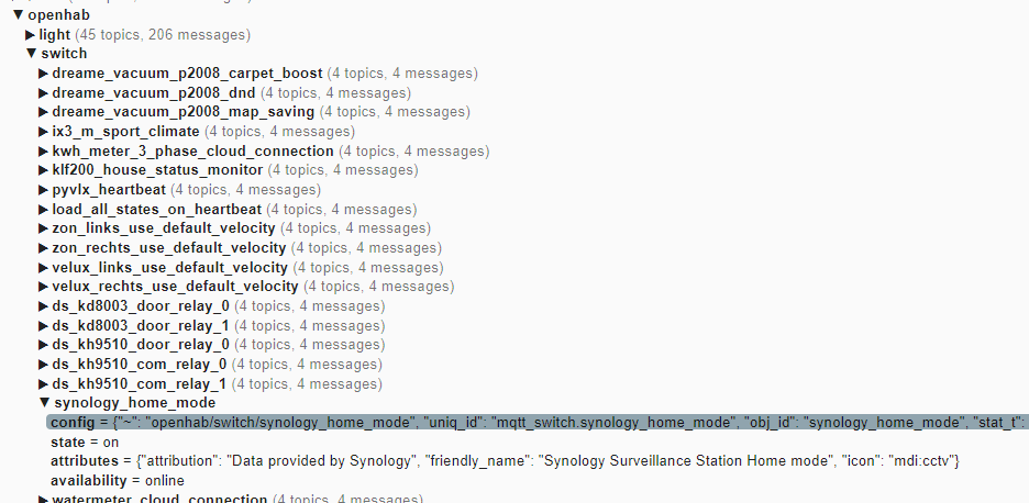

in HA, im exposing all light/switch entities to MQTT, i use a seperate base topic “openhab”
i see all my lights/switches in MQTT, so for example , i want to add thim item below
But its giving me an unknown state ? what am i missing?
