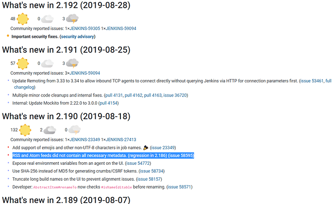

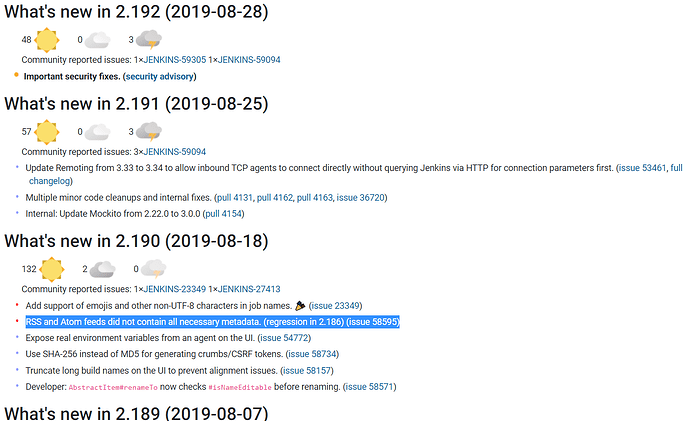

@Kai
Kai:
so it should hopefully be solved with one of the next updates (I do them regularly).
It has long been merged. See the blue mark.

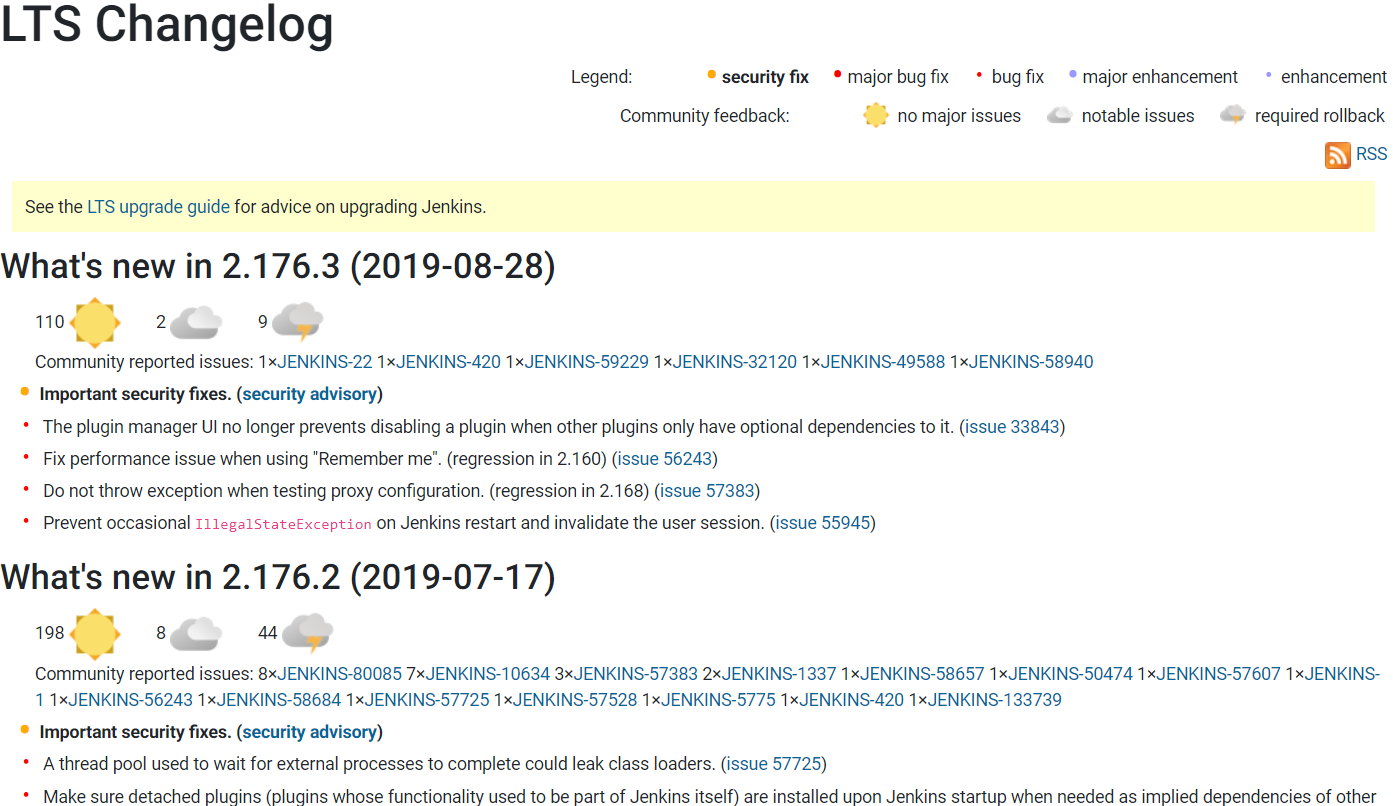

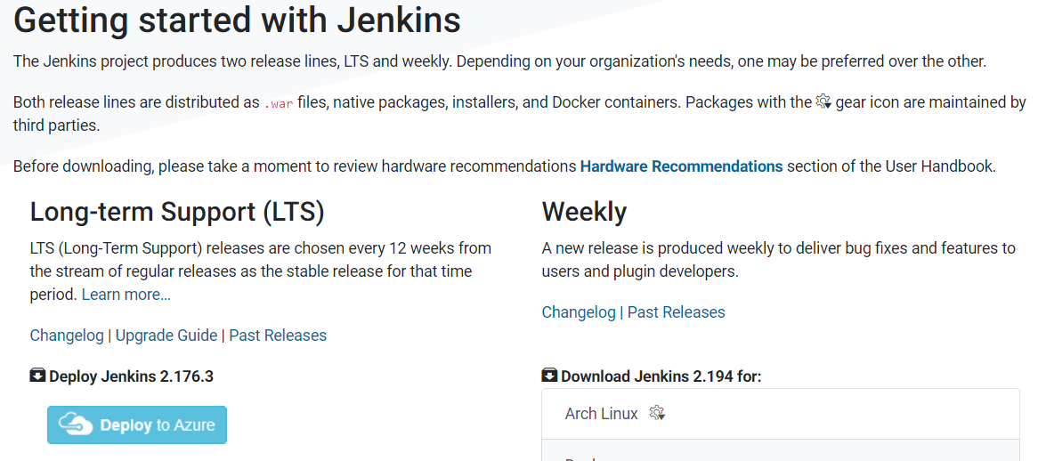

Do you execute LTS (Long-Term Support) releases (–> are chosen every 12 weeks)
or weekly updates (a new release is produced weekly to deliver bug fixes and features to users and plugin developers.)?

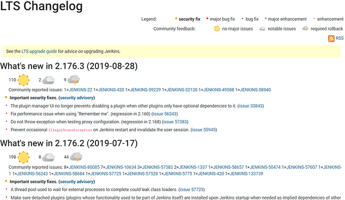

It’s still on 2.176.3 …
EDIT: Ok, I see, you use the LTS and it’s not in there!
I’m going to observe LTS Changelog now. Then I will recognize when issue 58595 will be merged there…
