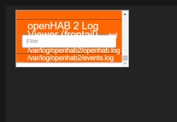

Do you know how I can get my static Logviewer Webviws formatted properly?
.sitemap:
Webview url="/static/frontail.html" height=20
I get only frame like this Screenshot by Lightshot
I set the local (192.168.x.x) IP of openhabian http://openhabIP:9001 is it right?

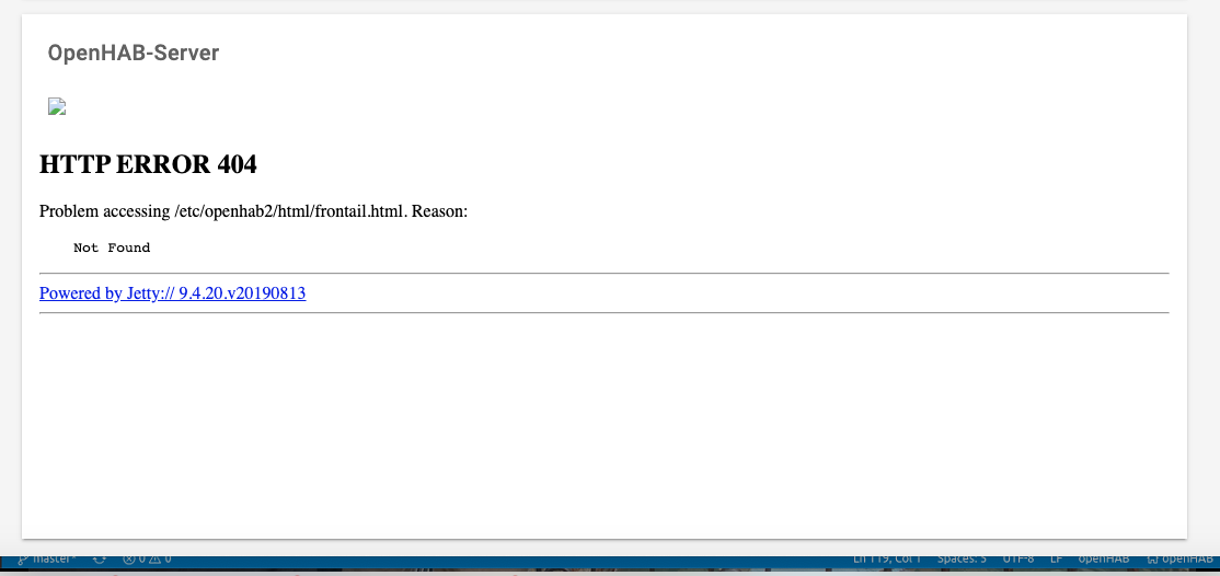

Hi All . i am also trying to ad the log view to my site map. but seems not to work.
html file :
<!DOCTYPE html>
<html>
<body>
<iframe src="http://192.168.1.5:9001"></iframe>
<body>
Sitemap :
Frame label="Logview"{
      Webview url="/etc/openhab2/html/frontail.html" height=20
it is a openhabian install on a laptop with ubuntu.
openhab ver 2.5.5
Screen shot
not sure what is going on
