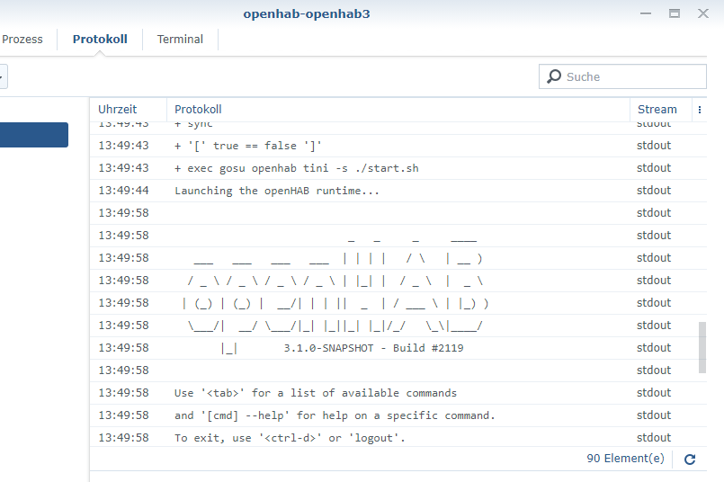

The log behavior is totally normal I think. For me it has been like this all the way back already with oh2.
The container log doesn’t show the openhab log files like openhab.log or events.log
So after successfully starting openhab (launching runtime) there should be no more logs in the container. Only in very rare cases I get additional log lines here, I think if an error on OS level occurs.
For the 2nd part (command line) I not really sure what you mean?

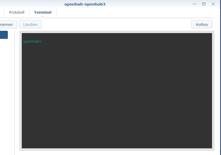

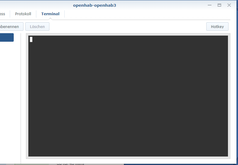

i can confirm that the protocol part of my container (in syno UI) mostly doesn’t show anything after OH has started. I guess you refer to this screen:
going to the terminal tab almost always shows me first a blinking cursor but nothing more:
hitting ‘enter’ one time then shows me this and i can use the karaf console:
Running OH3.1 Snapshot at the moment but this behaviour hasn’t changed for me from the very beginning of OH in Docker on Syno…

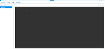

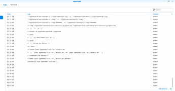

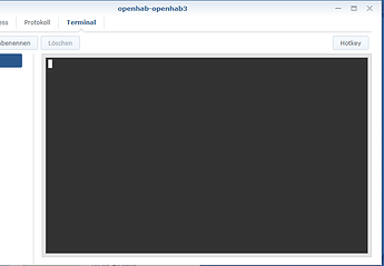

Here are my respective OH container log and karaf console below–the console does not respond to any keystrokes at all, and when I mentioned “command line” I meant the karaf console, my mistake:
as I mentioned OH seems to work fine so far but who knows what problems this could be causing me in the future.
The log output looks exactly the same for me. There is nothing more to log as this is the container log and not the openhab log. There should really be no issue.
For the Karaf console part I can’t say much as I never used it from the DSM Docker UI. I always log into Karaf via ssh from VS code.
I agree Sebastian, but was wary of my own conclusions. I’ll document if anything comes up
