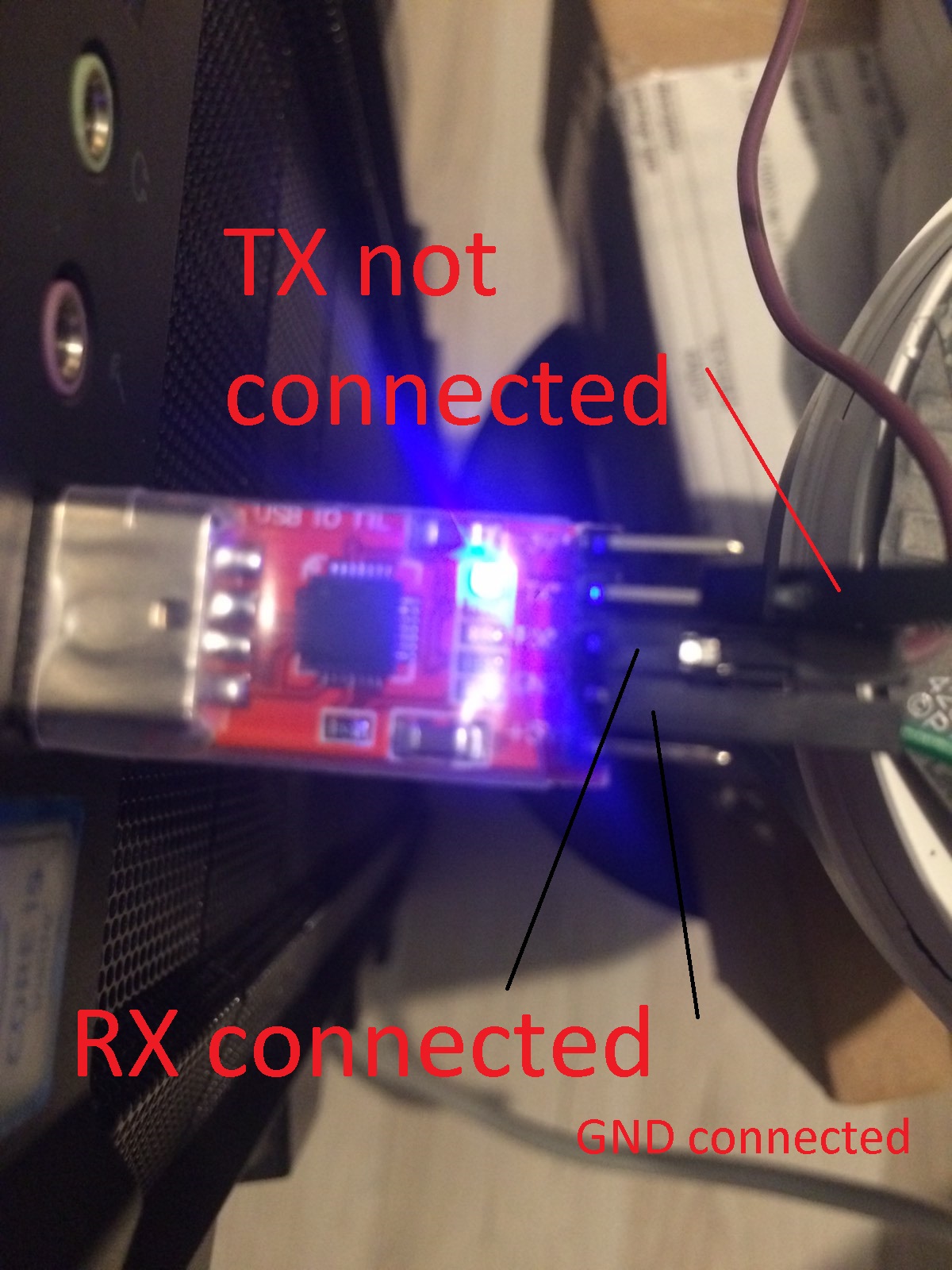

Hi, i wonder if someone can help me. I have followed the guide and have connected GND from TTL to GND of the Gateway. Then i connected TX from Gateway to RX on TTL and connected it to the USB. Then i powered the gateway. When i try to connect with Putty, i use 115200 for baudrate and COM1. Putty then opens a new window witch stays blank. I dont what im doing wrong. Any help would be nice.
Not working for me
I have been fighting with this a couple days now , but i finally got it.. ![]()
I had the same issue as you, with no output in Putty…
And the problem was that i wasn’t connected properly to TX on the gateway
So check the cable again…
I managed to get it working, port 9898 opened and discovered in OH.
