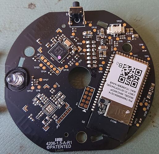

Also I have a few internal photos (if that helps identification)

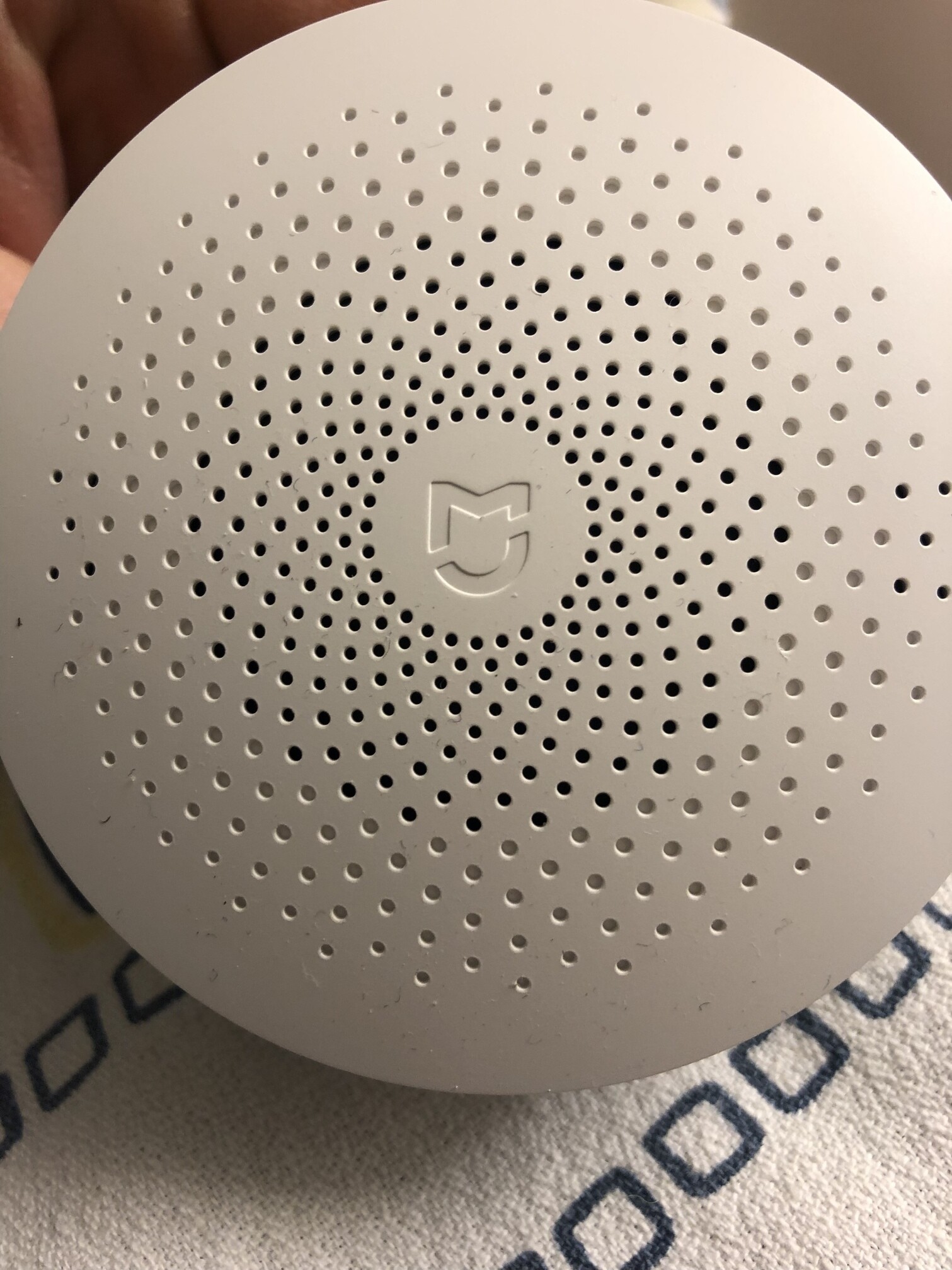

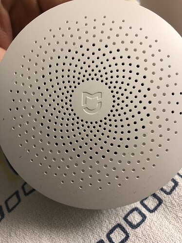

I have recently updated to 161…firmware my both gateways still works.. i think problem is with new Models in which Details are written in Circular Form.
I have this much information from Analysis. I have both Gateways. Firmware is not the issue
Old Gateway as show in picture works fine even after firmware upgrade.

Hi
Using Xiaomi Mi and OpenHAB since one year.
Here is the data from one of my 3 Gateways - still working. Hope it helps to find the problem.

Thank you, @asking, your post introduced very important information.
Could I ask the other users in this thread to check if the back of the devices match the above picture? That is, for “round text description” - it does not work, for “squared text” the udp protocol works fine?
If we confirm this information, we may need to edit the openhab documentation to warn future users.
Of course, this does not mean that the problem has been solved.
Confirm that I have the round text description on the device and it’s not working on udp protocol
