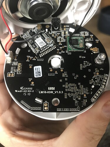

Just to be sure. The wire named RX must be connected to the RX of the USB to TTL (and TX to TX) or what is shown on the picture are the TX and the RX of the gateway ?
If I understood, normally, RX equipment must be connected to TX of USB and TX to RX. Or not ?? I am very confused.
Sorry,I believe my questions are certainly stupid, but I do not want to damage something… and I would like to get a result.
Also, I am not sure where the GRD must be connected, not very clear on the picture. And as I have no result… Is it on metallic part of the reset button ?
Thanks a lot for your assistance

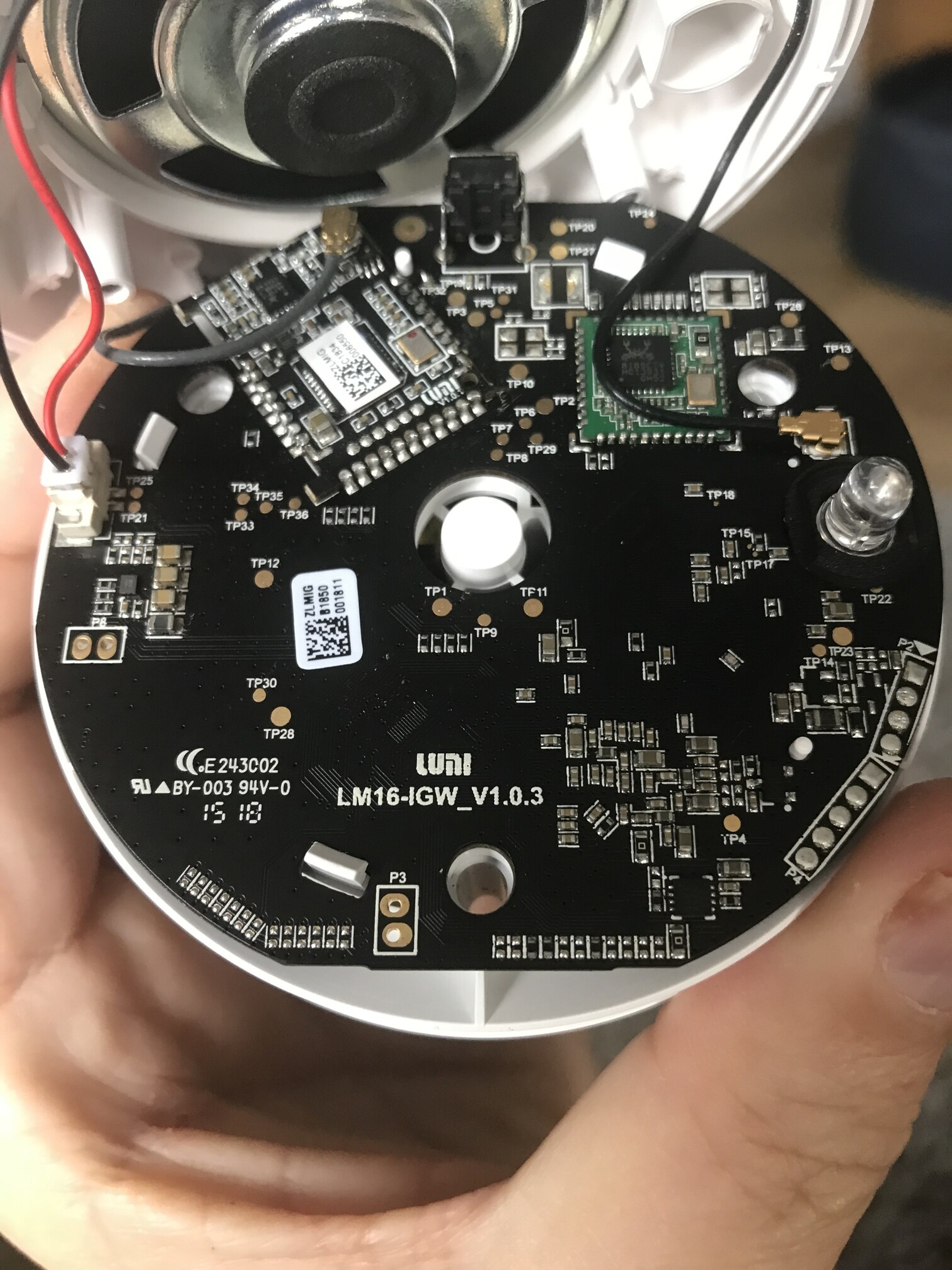

Hi! Does anybody know which are uart headers in this Version?
