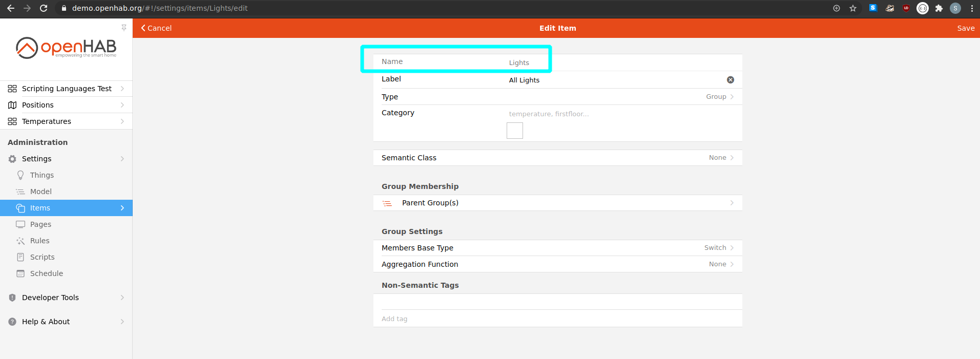

In the demo there is indeed a group which is called Lights
demo_group-lights
… and then you can probably work with <group-name>?.members.forEach loops.
