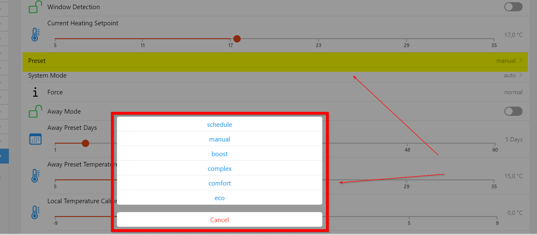

the result is

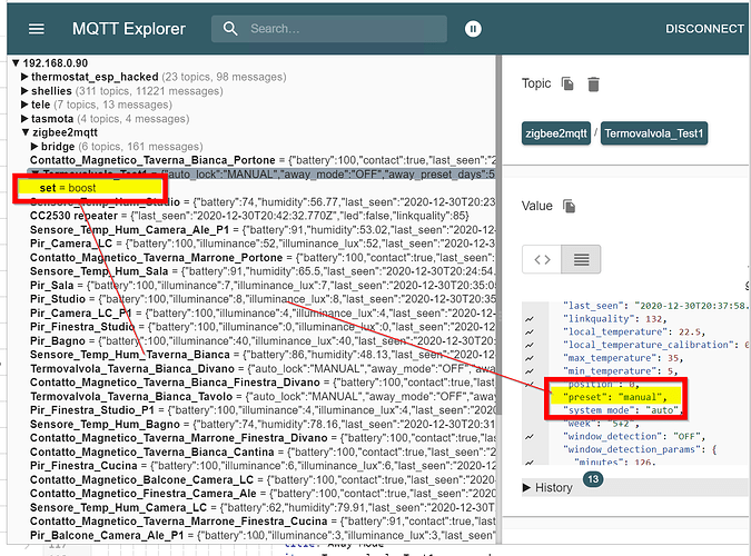

when I change the option, the result in mqtt explorer is the following
the value doesn’t change…it seems that send only the value without brackets and ā€œpresetā€ string

Now there’s a UI problem.
Is that what your screenshot is supposed to show? I can’t see the result you describe…

i better check configuration option for list-item component and it’s possible to define a list of values with format value=description, so i changed the page UI yaml file as follow:
                      - component: oh-list-item
                          title: Preset
                          action: options
                          actionItem: Termovalvola_Test1_preset
                          actionOptions: '{"preset":"schedule"}=schedule, {"preset":"boost"}=boost'
                          after: =items.Termovalvola_Test1_preset.state
note the value=description in line: actionOptions: ā€˜{ā€œpresetā€:ā€œscheduleā€}=schedule, …’
and please note the ’ at the begin and at the end
