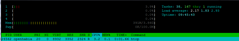

Can you do a htop or a top command once your on the shell? Then you’ll see the process load and if that’s the issue. Also, is your Pi cool enough? It will throttle once it’s overheating, but with just openhabian running that is probably not the case.
What kind of USB drive did you use? Have you configured it with the openhabian-config tool?
Bob,
Your going to have to forgive the newbie here, how do you do the htop and top commands. The PI is cool as far as I know the fan is going and I feel no heat on the exit of the fan. I just used a USB stick I had laying around (not to sure what it is in terms of type/speed). I did configure it through the config screen as outlined here… 7:20 of video
Have you looked at the official documentation written by our knowledgeable developers? It is quite good and you should not need any other installation documents.
Oh if you’ve got a fan you’ll be fine!
Just connect with putty as you already did, then enter htop and press return. It will bring up a task list along with some load info.
